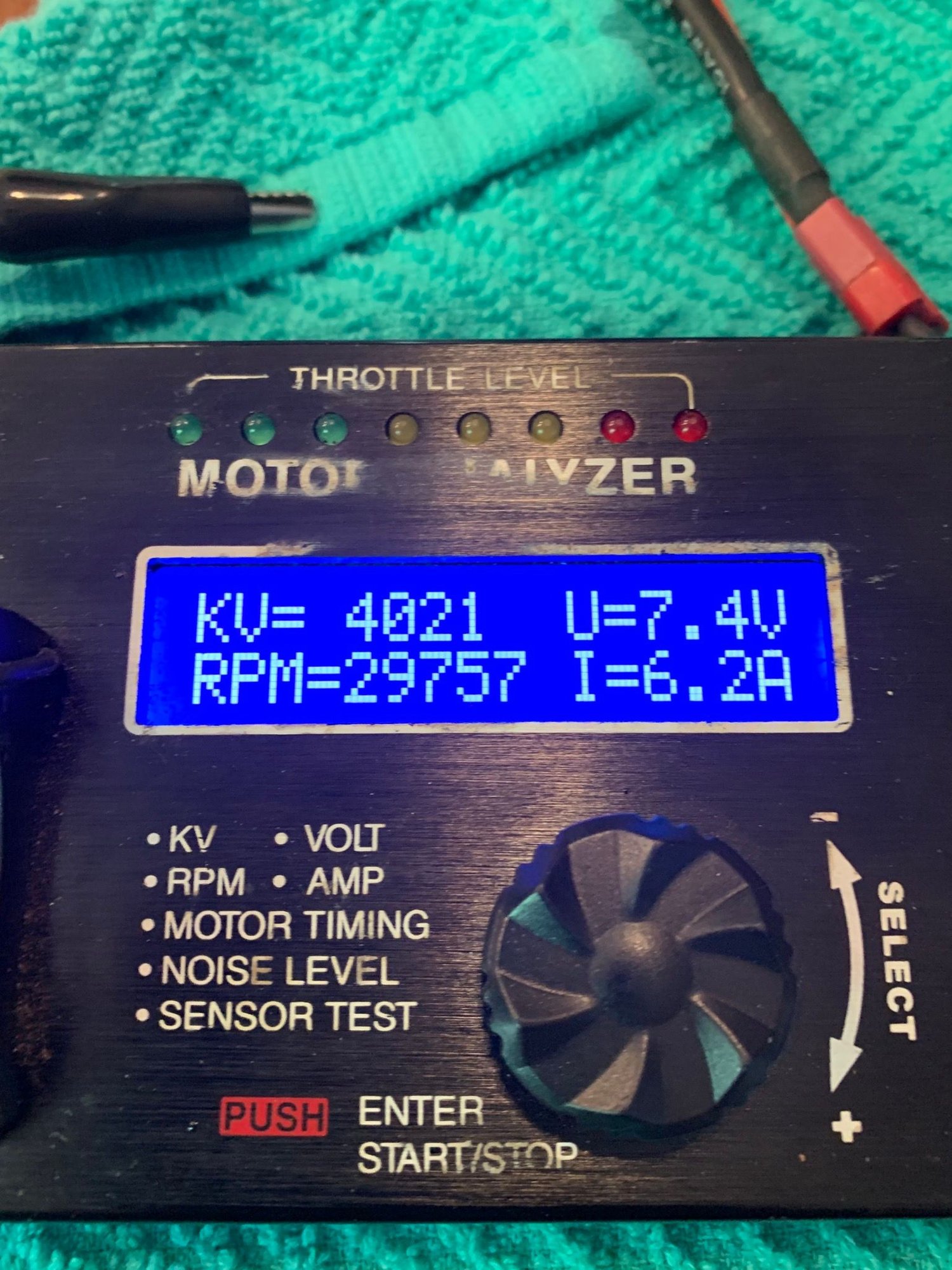

Default out of box
Originally Posted by Marcos.J View Post
have no idea i guess i need to find a very weak rotor to test that out i'm not a motor expert but im sure if the rotor is shimmed too tight will add more amp draw
Out of box

Default 48 degrees

Default Last pic
the first two are out of box, next one is at 48. The rotor is floating in a neutral state with about .010 end play, and is about a tiny bit more than a header card off the sensors. I just looked at your numbers again, thsr has got to be a 17.5.

yes a 17.5 , you have a good sensor board for sure

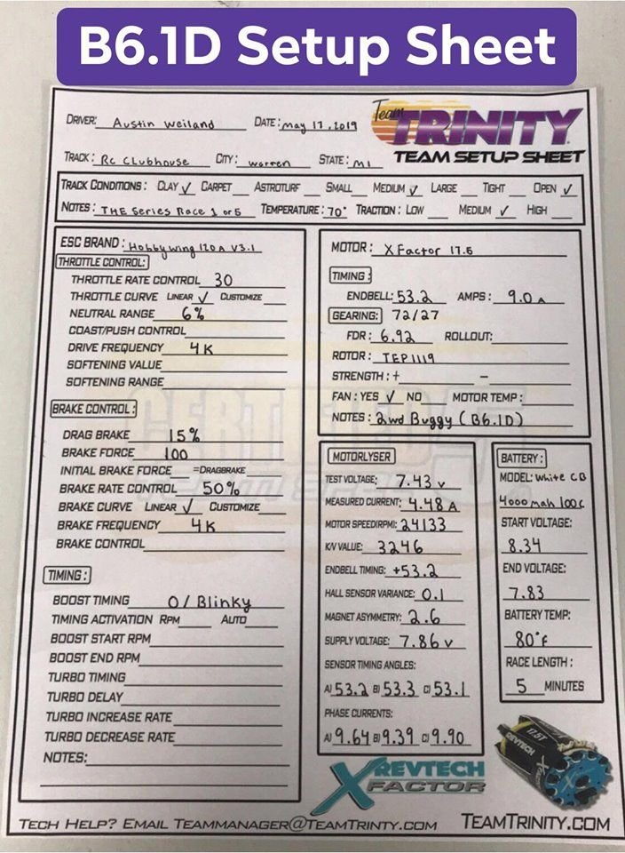

i need some gearing help please. background: im driving a b6.1 fl on a med/large indoor clay track with med/high bite. sdrc raceway in socal.
i just ordered the x-factor 5% 17.5 and a 21.5 monster max. can someone please help with a gearing starting point on these motors. lots of s-plus guys at my track but not too many trinity.
try this
i dont run off road but i got this from the Team Page
