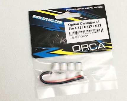

Originally Posted by alecladanga View Post
the single capacitor which is similar the the LRPs is my replacement cap as well and since installing it on the b32, it has been running very well and no symptoms whatsoever
Yep. I’ve got same. Haven’t run them yet though.
But....
Apparently this is the one we should all be running.
