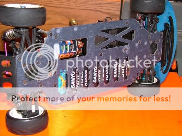

Hey guys, found something for those who run their BMI on the road, or inside carpet might be interested in. We all know that we dont want to ruin our nice investment so this chasis protective sheet might help.
-It's about 1mm thick. Pretty easy to put on. One tip though, have a sharp hobby knife to cut this stuff with, as you see mine was a little dull, so it looks a little messed up, but its worth the protection it gives in the long run. If you have already put your chassis together, cutting everything out will be a pain, if you just got yours, and its not put together yet, put the film on first, of course there will be stuff to cut out, but like were the screws go to save time and fustration, just make a little hole or cut, and tuck some of it under the screw.
-Any way the stuff is made by Team associated, and the part number is 6312.
-Just something to think about for those who want to add some protection to quality work.

Using this stuff is great for protecting the underside of the chassis. However, keep in mind that your settings may be slightly off with the added thickness of the chassis protector. The car will appear to be lower to the ground, with the underside bottoming out more. If you compensate for the thickness then you should be good.

-Already one step ahead of ya bud
