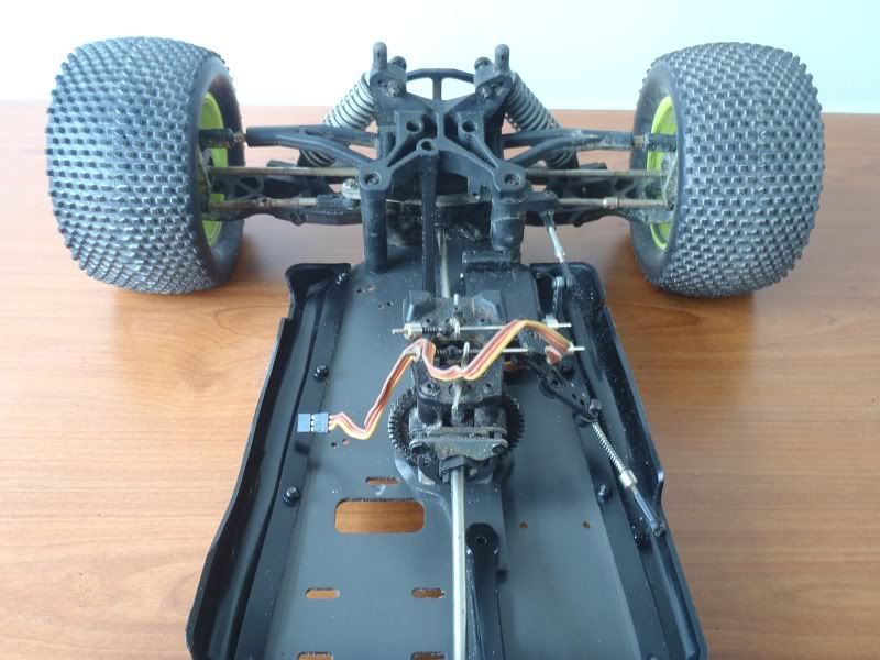

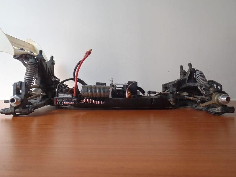

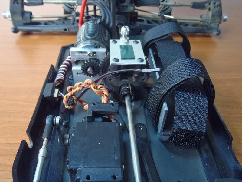

Arrow Electrifying - Hyper ST

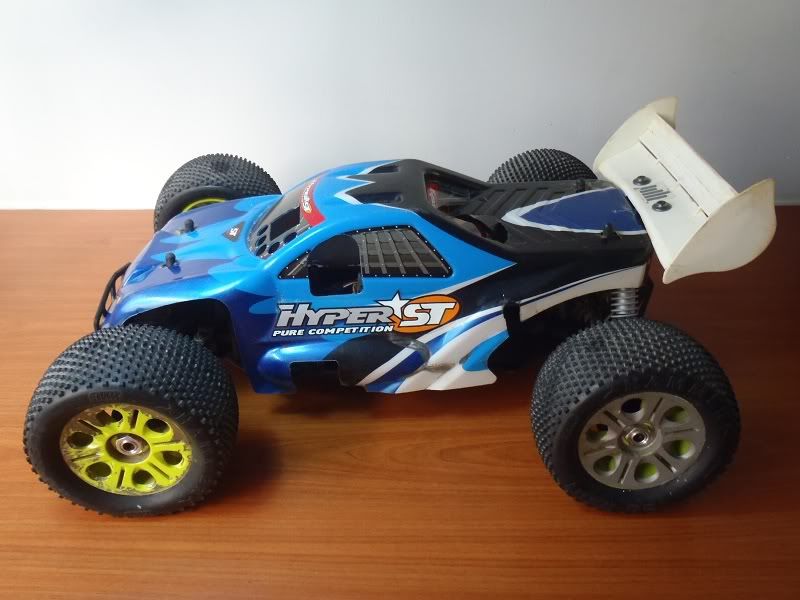

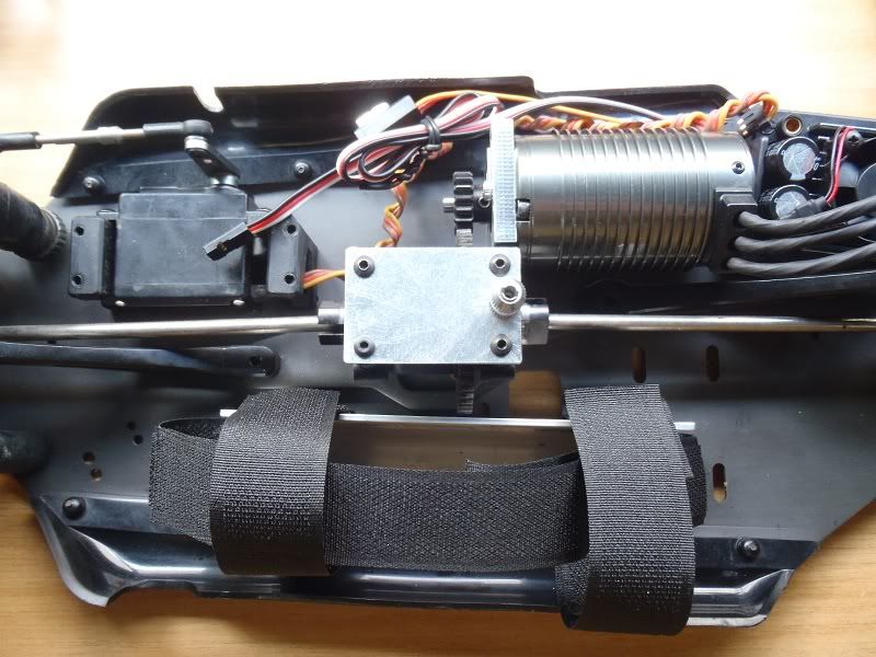

Hobao/OFNA Hyper ST! Tough truck with gentle price tag!
Very Short Story - Tired of dealing with nitro engine care and handling; the owner wishes to have nitro out, electric in!
Agenda - Convert!

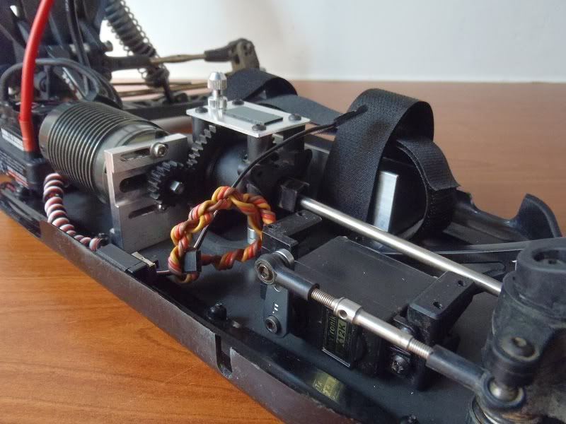

Being a high performance Truggy, CG is extra critical for this particular conversion and it is extra challenging to keep costs and complications low while figuring out component designs/positions in this space-constrained truck. Fingers crossed!

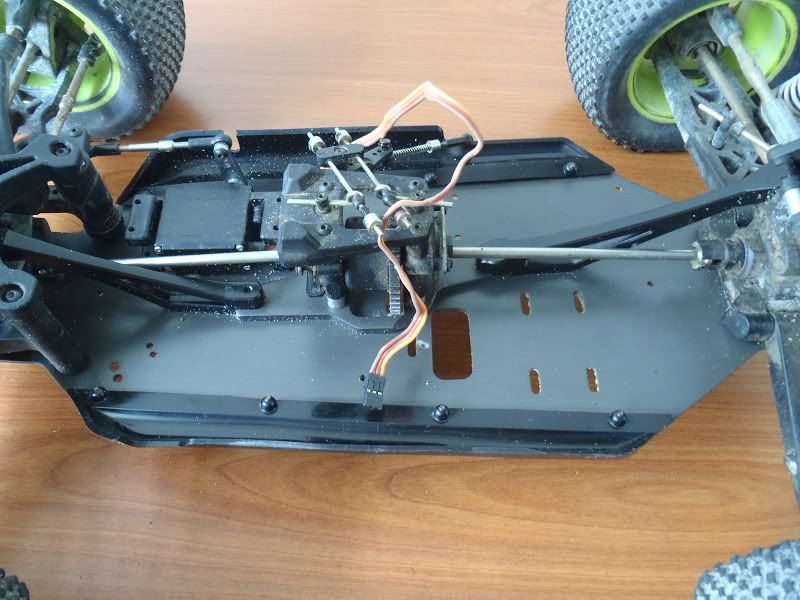

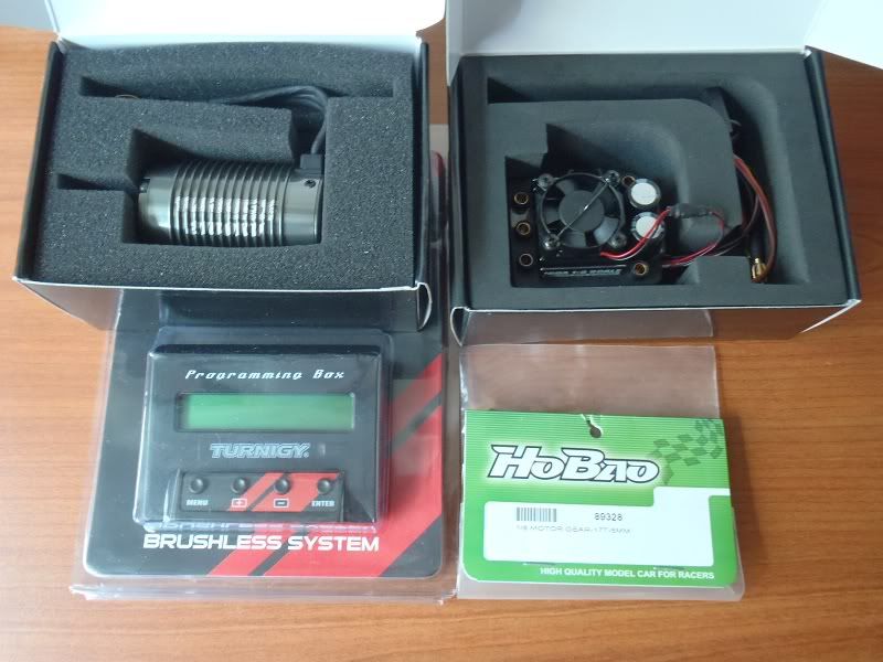

1. Sight See

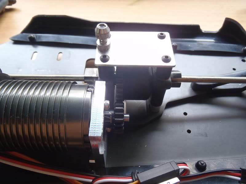

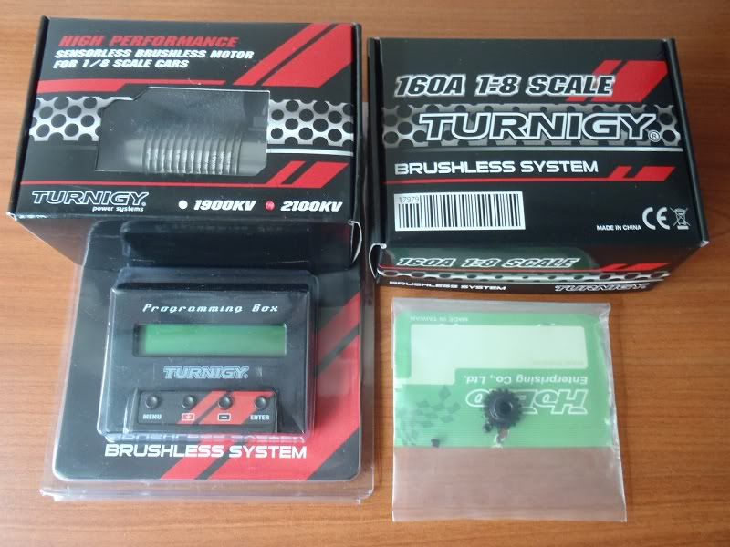

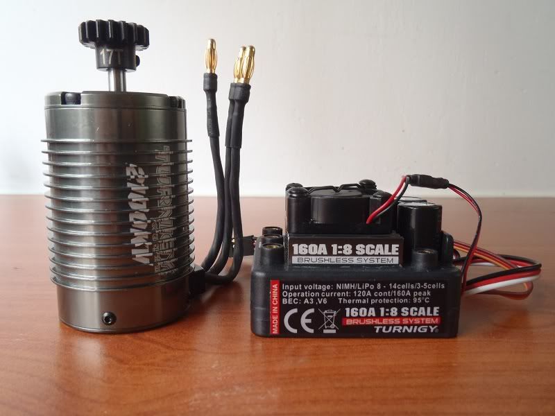

2. Power Plant

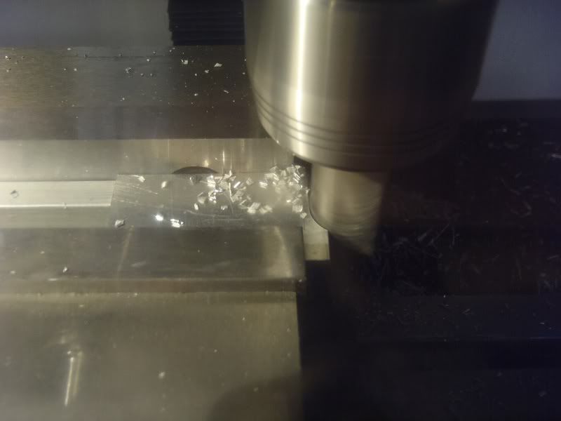

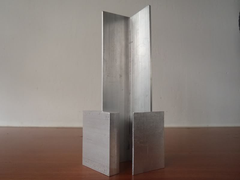

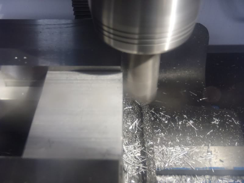

3. Metals
That's it for today! Next time - Metals II!

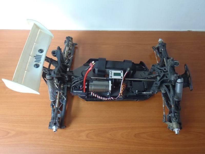

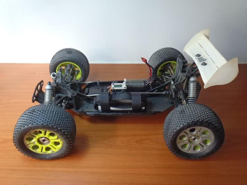

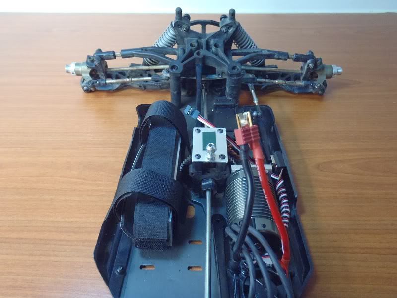

4. Metals II & Completion
That's it for today! Up next - Test Drive!

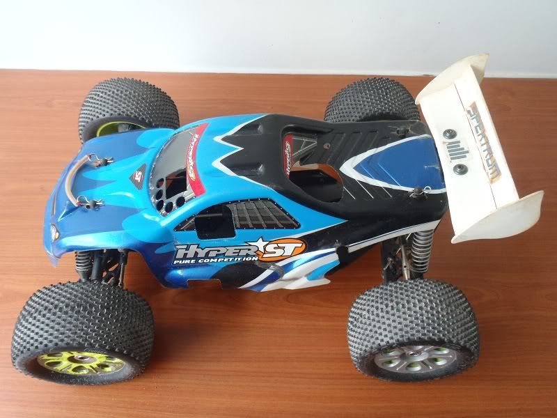

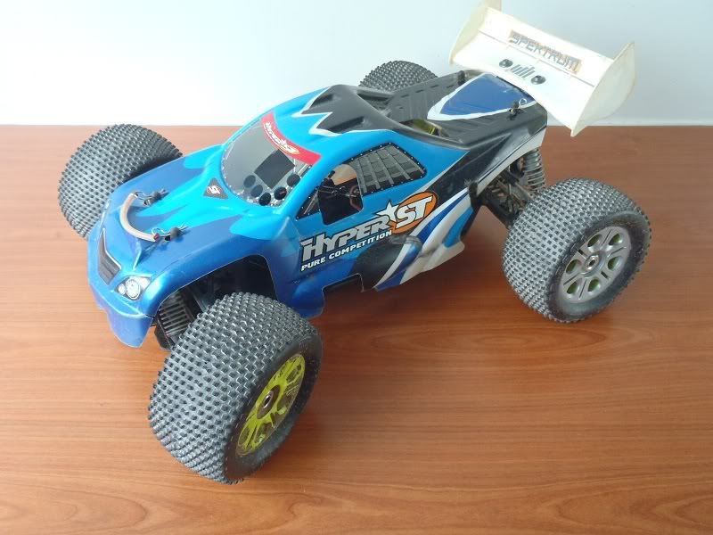

5. Impromptu Test Drive
+ YouTube Video
+ YouTube Video
Yep, the owner had to leave for a supreme holiday tomorrow so we had a quick meet for a quick drive. It was fun!

Bro, that no problem now after get new rx from Winnie. Everything fine, now my son can play happily with his ep rc.
Nice video for the truggy. By the way, how much u bought for that brushless combo?

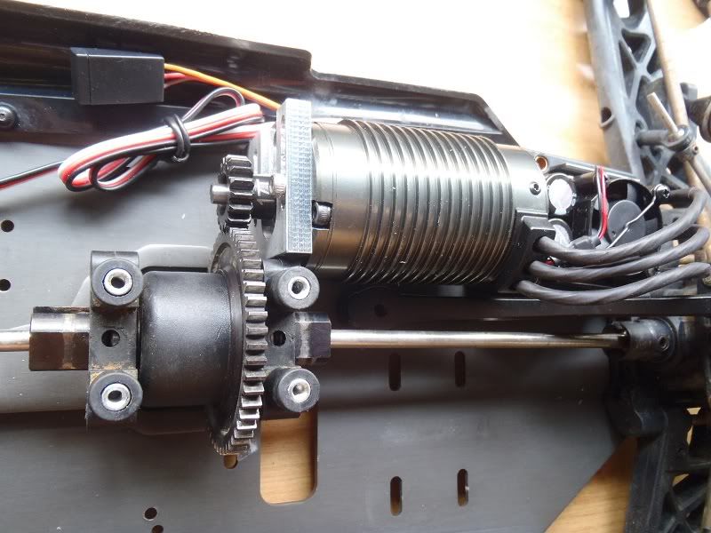

Posts: 509
u got a wicked combo....
but 17T?? wats d spur gear count??
btw, i found out my 1/8 is 46T spur count... wat pinion u tink i shd mate it with??

That's great! and thanks! The combo is priced at <S$150 if I were to order it for you.
It was a very good combo, not great, but good. It is on a 52T Spur. For your buggy setup, you can go up to 20T but I will recommend to stick between 13T - 15T. 15T being the most popular for most setup. Please remind me again about your motor and ESC rating.

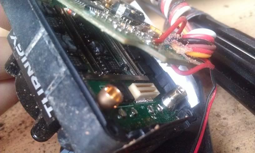

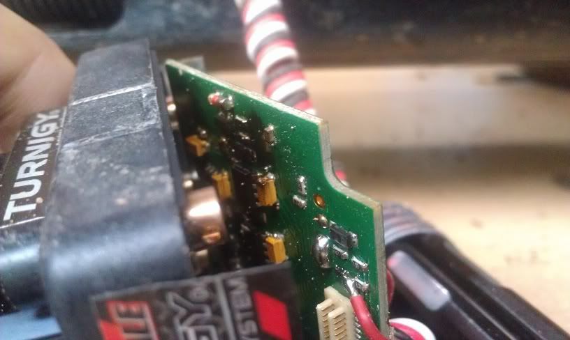

7. Moisture Damage
Yep, pretty fried up. The electronics survived the whole of yesterday's mud bash but today's super wet mud bash gave the ESC it's last breath. I suspect that the Deans connector shorted a little which caused the ESC to smoke. This is one of the main reason why I don't use Deans. However if you are still with deans, remember to tape it up for a wet bash and always keep in mind that it is always a gamble to play in wet situations.
FT is offline

darn.... a nice esc juz gone up in smoke. nice jumps u got on d ST. on 4s or 5s batt??
viktozzz is offline
Old 10-14-2012, 07:29 PM
FT
FT's Avatar
Join Date: May 2006
Posts: 1,050
Yep, a real waste. I was not around when they took that segar video, but from the youtube clip, it looks to me like a real performer! It was on 4S (2x 2S) with a bloated pack. Yesterday, I was around to witness only 2 laps of run but the track was really drenched from the heavy rain. Weird things can happen when water meets EP.
