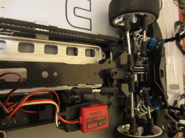

Please find pictures attached of the car. I have slowly been modifying the car from the base setup to find something that will work on my carpet track.
I needed to increase the height of the servo and use a longer servo horn to clear the square edge of the battery pack. 7mm of spacers added to steering block to eliminate bump steer.
