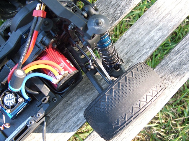

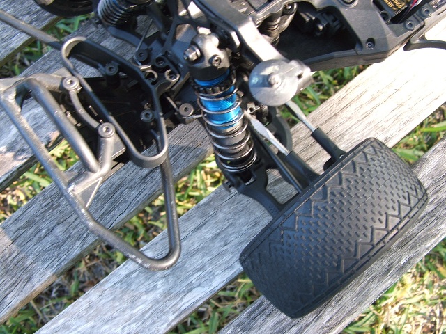

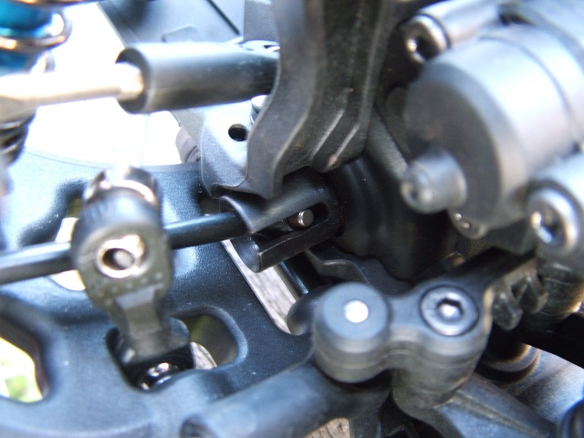

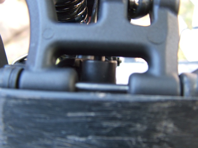

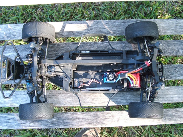

Krio, here are a few pics of the RPM arms installed. Not quite sure what you were looking for, so tried several different angles. Just a general overhead, then shots of the front and back. Last 2 are the front suspension fully compressed. First one from the top side, looking at front of truck. Last one frim beneath a-arm. WHen fully compressed, arm is still about 2mm from outdrive, but I have shock boots on. Hard to say for sure, but there may be a chance it would clip the outdrive. Rears I don't think would have any problems. When I get a chance I'll take the boots off and see.
