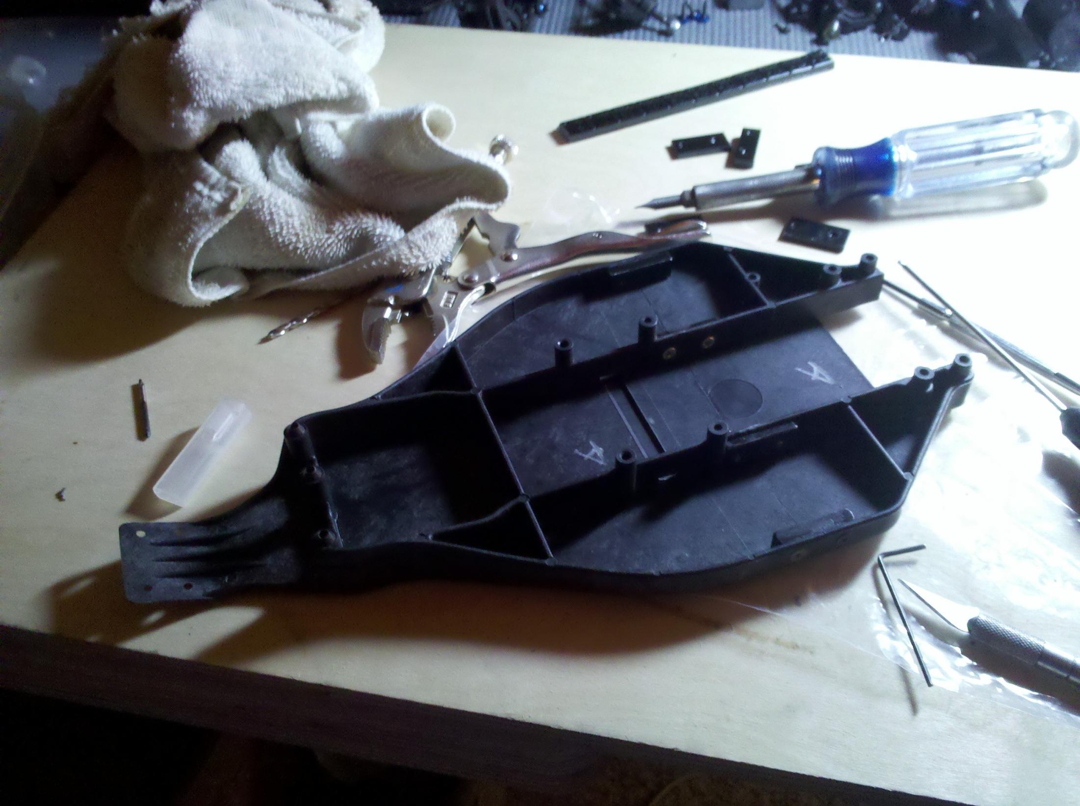

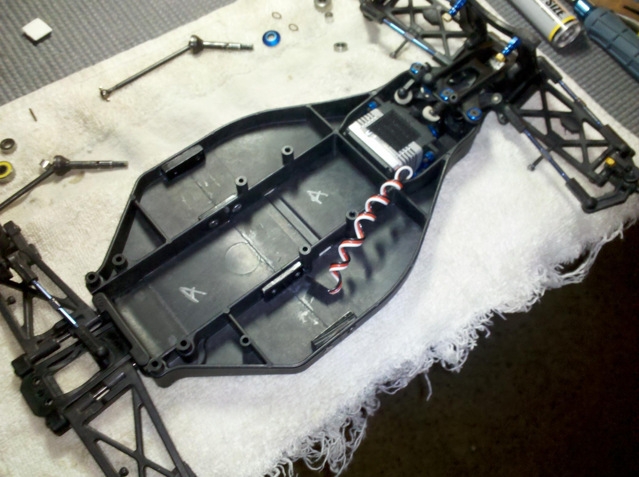

Finally got my chassis cut. Ended up using a table saw to cut it. I glued and braced the chassis with aluminum blocks I drilled and tapped and secured with 4-40 screws. First run on it will be tomorrow. Pictures are attached below. Forgot to snap one of the bottom, but you get the idea.
