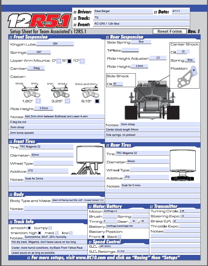

Originally Posted by YR4Dude
How about a base set-up for mod at TQ?
Working on getting the 10.5 to run with the SPX.
Here you go sir.
