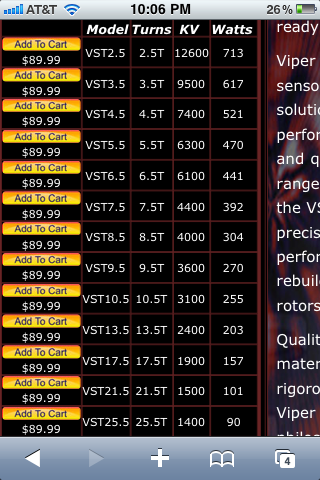

Originally Posted by DBL15
ok all good and done
just running on profile 8 for now until i work out how to use it right
any know what kv a 7.5T =
so i can start to set my profiles
Assuming you picked up a VST 7.5 to go with your esc, with stock rotor and 30* timing our 7.5 is 4400kv.
Edit: This table is helpful to have on hand when tuning our boost function
