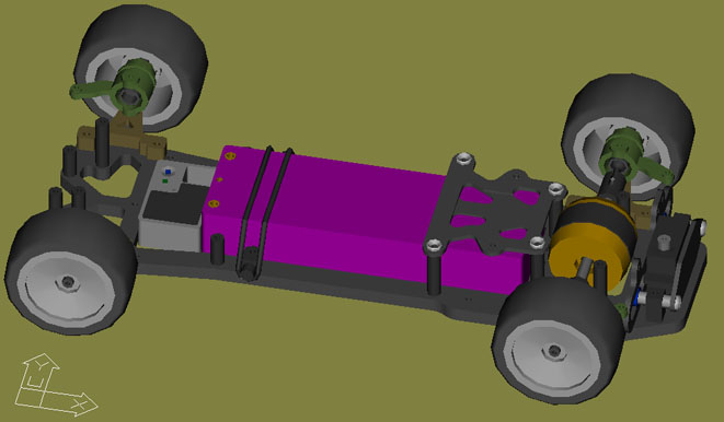

Originally Posted by monkeyracing
I think it's crazy. Keep up the good work!
Is this being built for top speed runs?
No, it´s designed for any kind of track, but I need to find the right motor that would handle the abuse of being part of a solid axle...
In fact, I did found it...
Some details about the car:
Wheelbase: 210mm
Width: 165mm
Ground clearance (adjustable): 6mm
Weight: 950gr (track ready....)
More pics of later developing stages...
