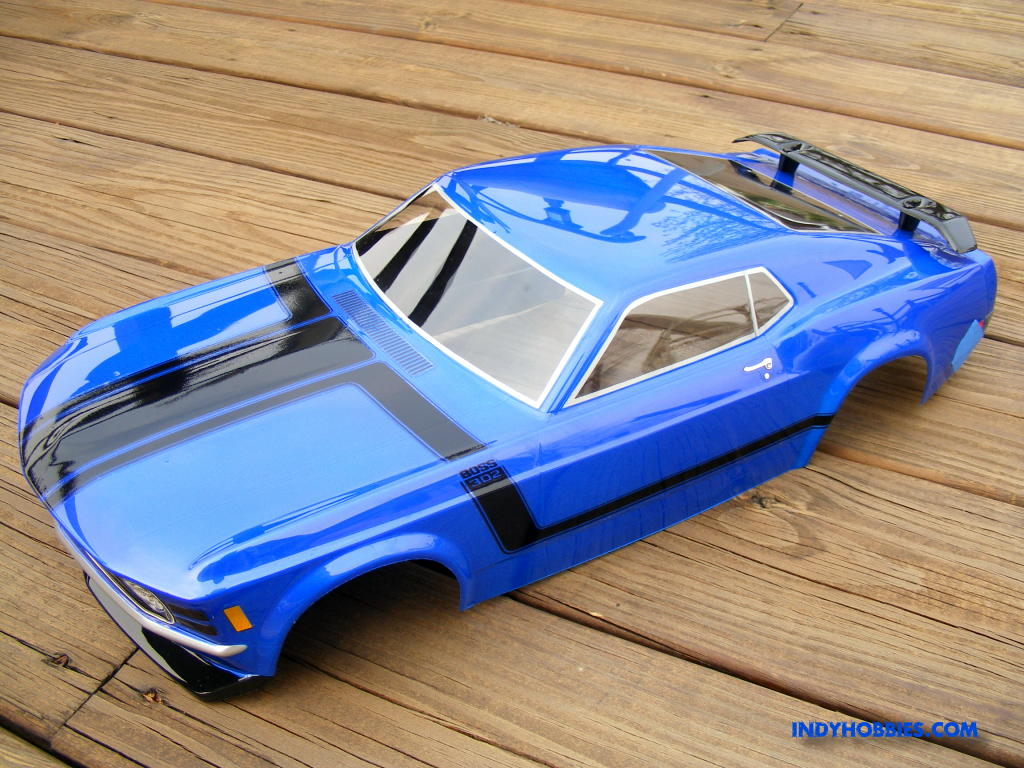

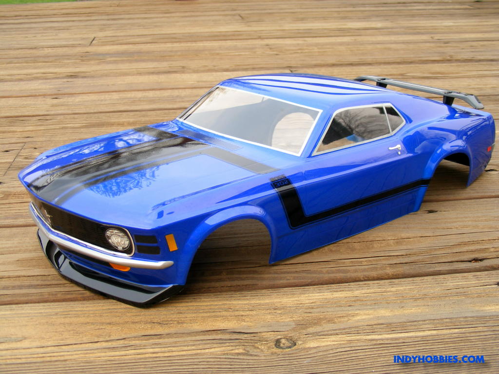

I was able to get some time this afternoon to paint my new HPI 1970 Boss Mustang body. It turned out pretty good I think, I like the blue. The actual blue that Ford used was a wee bit lighter. But this is Faskolor paint and I love the metallic blue they have. Deep color. Backed it with faswhite and then a light coat of black.
The rear decal is not attached yet because the shoe goo was setting in the back to attach the back bumber piece.
I decided to use liquid mask for the bumpers and I also painted the window frames on this body rather than use decals. The black stripes were going to be impossible to attach without using windex and laying them on wet. Once I did that, it wasn't too hard to do.
NICE BODY HPI!
I've not decided yet if I want to run it or sell it. I'll beat it up pretty bad if I run it!
More photos below:
