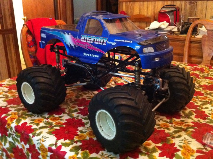

this is my clod. it has a new era models roll cage chassis. i made my own links for the 4 link and steering. i locked the rear steer, front mount servo which the bracket me and a buddy of mine made. it has rc guy uper link mounts. and hot racing asle tubes. for electronis i have a novak soer duty xr esc and 2 trinity gem series sappire 17 turn motors. more work needs to be done. got 129mm shocks on the way for it. me and mu buddy are going to make shock mounts for the axle and i want to get a set of 1 1/4 widners from TTR
