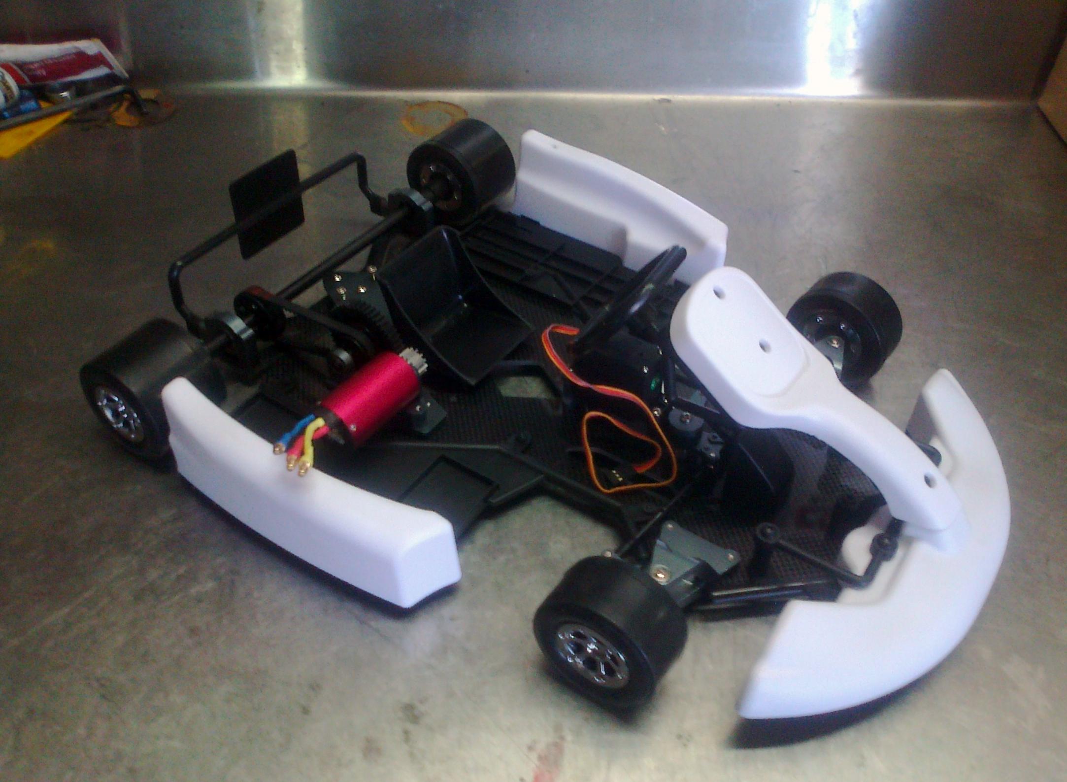

G'day guys now for sumthing a lil different :P ... basicly saw on the hobbyking.com website they made a 1/4 brushless kart that look pretty trick .. being that i live and breath go-kart racing and raced for 10yrs and still very involved i thought this would be a sick project to turn into nitro ..
Attachment 700174
Attachment 700177
Attachment 700179
Attachment 700183
that is how it came ... BL motor on it and only needing a esc and radio gear.. but

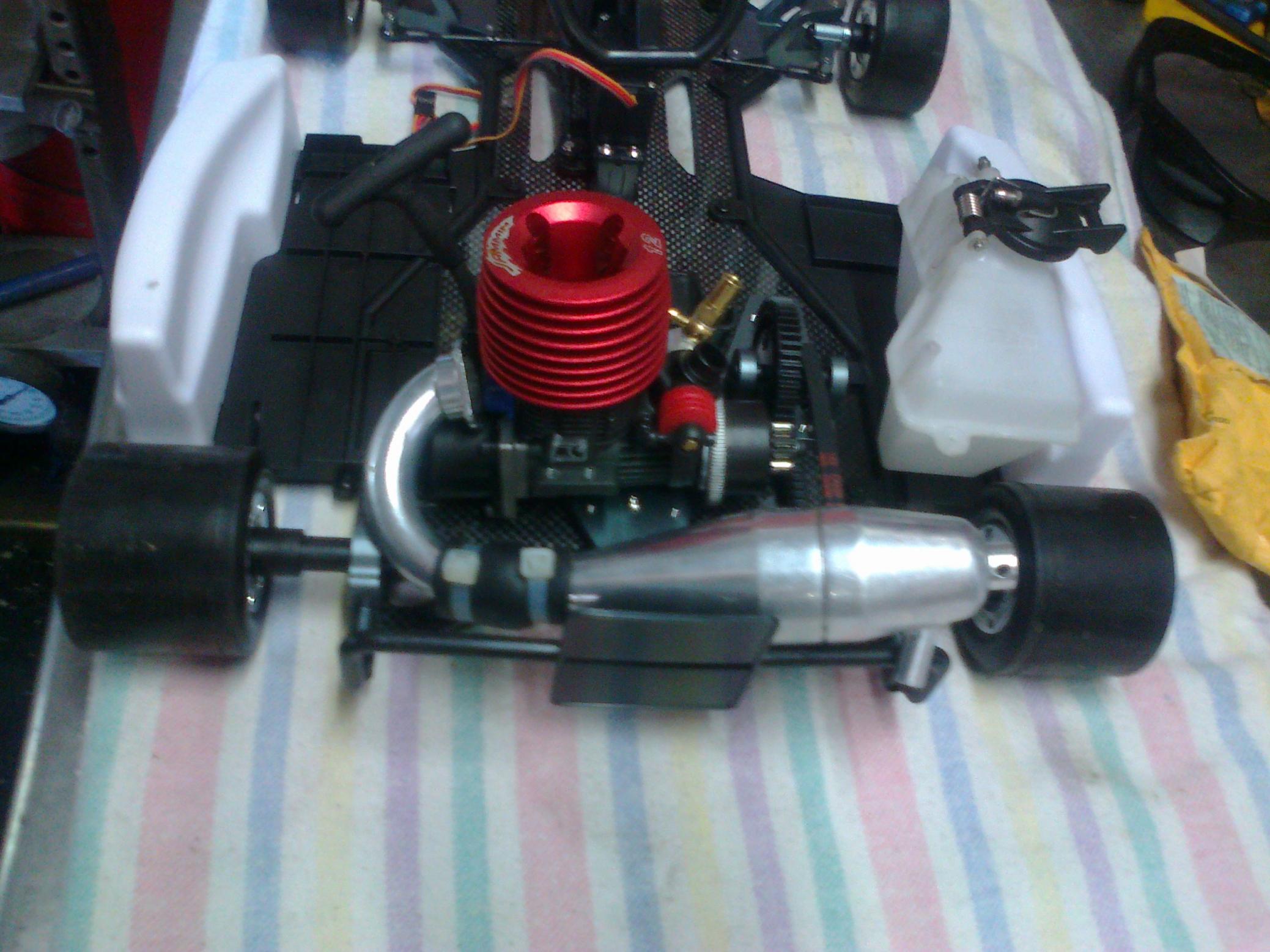

next step was to mock up the engine.. i went for a JAMMIN P/S .12 for the simple fact i had one new on my shelf gathering dust and it worked out great because of how the exhaust bends round..
i did buy a chain drive set up off the kyosho kart to run but when this kart got here i worked out the spur gear was the same pitch as the clutch bell so i changed how i was gunna mount it ... right behind the seat..
