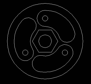

Originally posted by Ducati-Rider
I think the 8 o'clock clutch shoe lays from the pin at 8 up to 12 basically
as the motor spins counter clockwise - is this correct?
something like that ?
