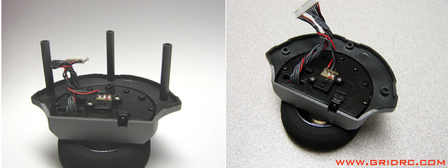

Hey my mom is ordering one tonight,what post needs to be modified?So i know before i install.
The posts on the steering wheel bezel are the only ones that need to be shortened. The plastic is very soft so it is easy to trim. Take a little off at a time so it is flush with the edge.
