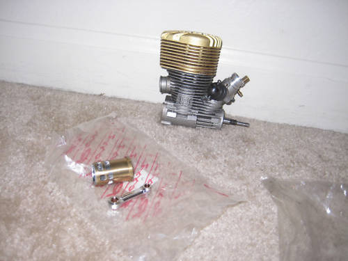

you can put the black magic and golden arrow head on the momba and cobra engines
the only problem is the exhaust manifold might have to be growned down on the top sense the new engine case does not have the angled exhaust outlet
here is a picture of the golden arrow just like the black magic except old style carb
now the hps 2000 have a differnt head and head button "smaller but same design and shape"then the black magic and golden arrow
