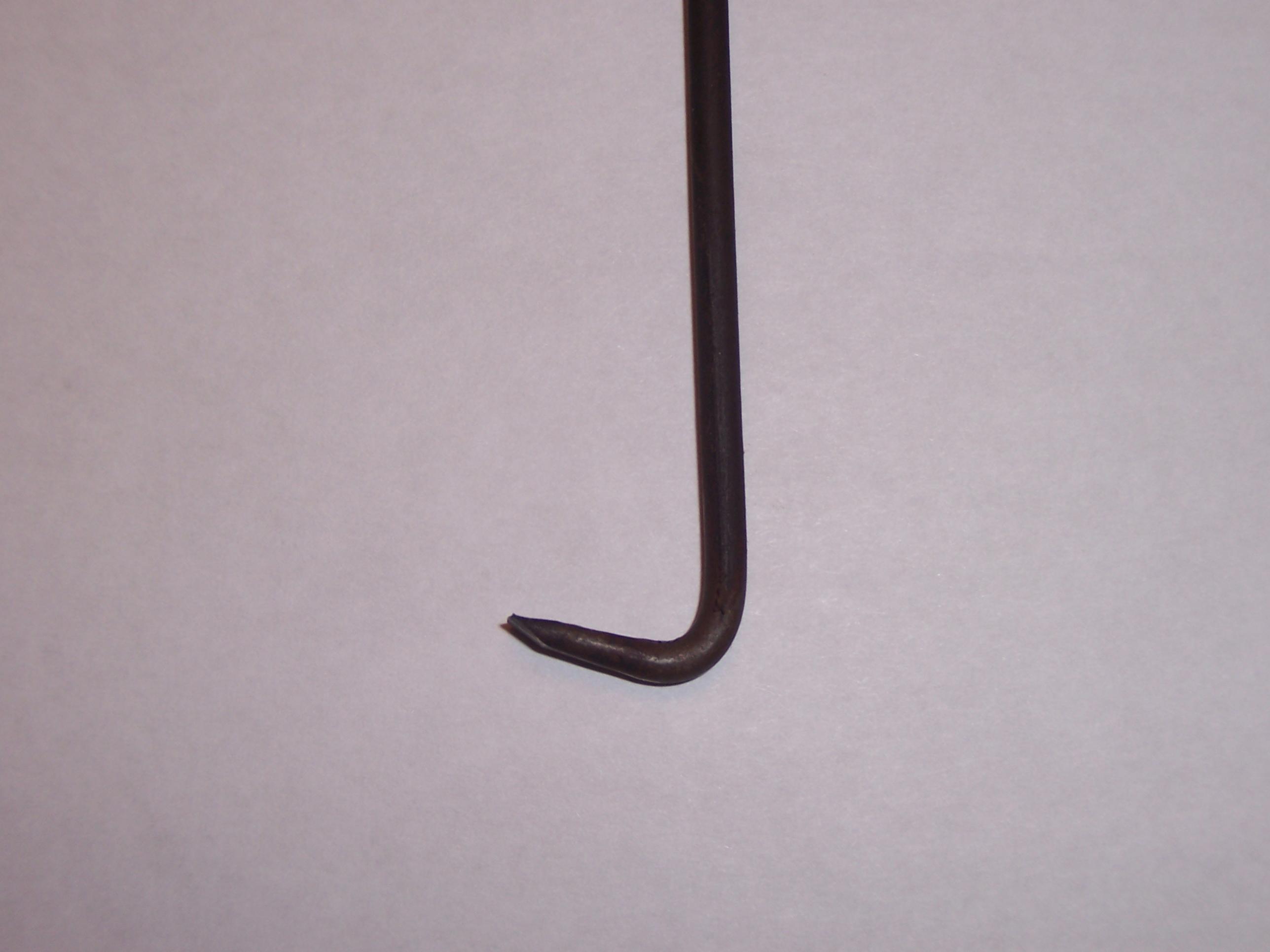

Default Con Rod Tool
Crude But Effective
After removing sleeve put few drops of oil on crank pin insert Tool under pin
wiggle do not pry it should come right off.
