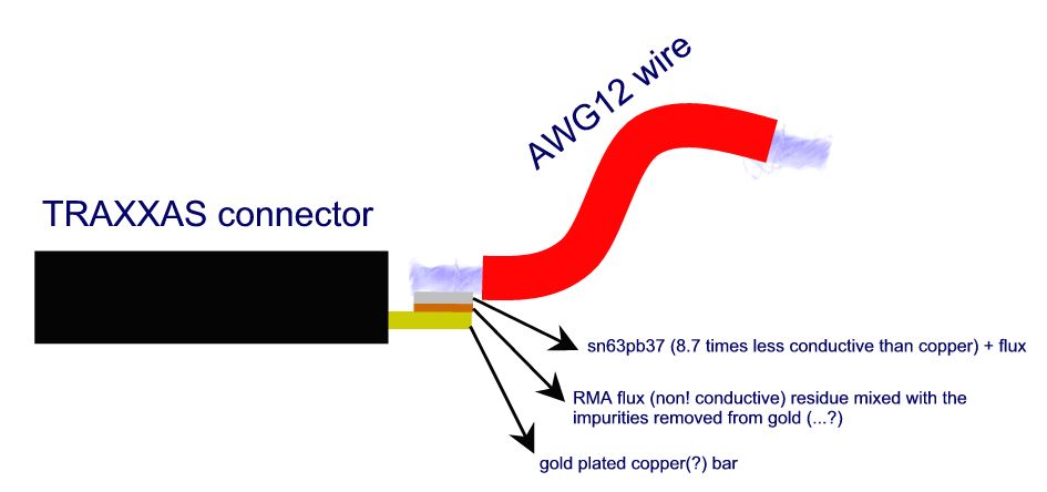

Originally Posted by Imbuter2000
How can that non conductive flsolderux residue, along with oxide and impurities that remain inside it, be an advantage in the electric conductivity of that?
how can you remove that residue if it remains between the tin and the bar, incorporated within the soldering?
That example can never happen, (on new components) the only time I see something like that is when the component is VERY dirty, and the flux can not do its job. In those cases, the solder doesn't even begin to stick to the components and the wire would not make a connection and when you clean the sticky flux away it comes loose. Trust me, you WILL know if the wire is not connected. To get so much corrosion that you have that problem, you would need to soak the connector is salt water for months.
Flux can not mix with metal, there will never be a mixture of flux and solder. Flux will remove the oxides from the metal surface and leave fresh clean metal for the solder to stick to. The solder creates a molecular bond with the metal, that can not be separated again. When solder gets put on that shiny gold connector, it will forever remain silver looking, the solder will remain on there unless eroded away with something like sand paper. If you can see the solder flowing and sticking to the component, then you are fine. There is a reason why solders come with flux cores, flux is good.
Simply put: Flux will do its job and then get out of the way.
When the solder starts to stick to the component the flux will not get in the way. The molecular bond is much much stronger than the physical stickiness of the flux.
