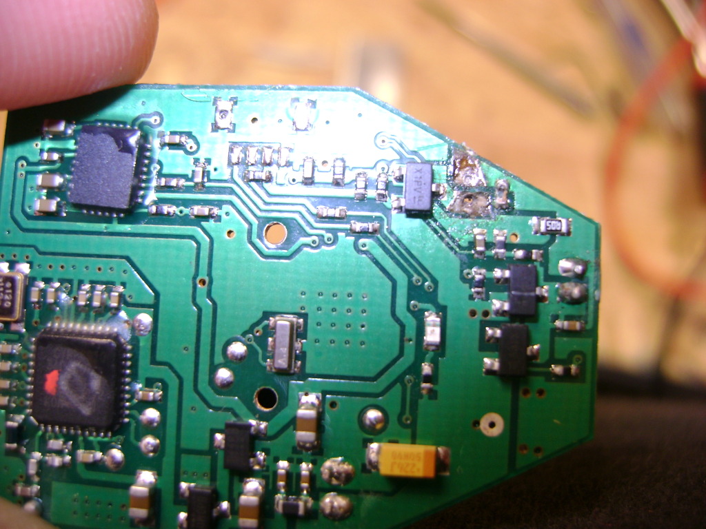

Now the biggest issue with the amount of heat, is how long you need to hold the iron to the component being soldered. Heat can damage some components. IC chips and some diodes are susceptible to heat damage for example. Another big issue is that the heat can travel down the component and start to melt the solder connection at the circuit board, (or the connection on the other side if you are soldering directly on the board) this can cause cold joints, or poor electrical connections that can cause resistance and poor performance. Robbing you of voltage, power, and speed. In high current applications like ESC's and battery packs, resistance causes heat that can cause even more damage to solder, battery or board.
Circuit boards themselves are also very sensitive to heat damage. Heat can damage a circuit board substructure, (the actual board that the components and traces/connections sit on) be it from holding the iron on the connection too long or a poor connection causing heat when high amps run through it. The amount of heat needed to damage the board is much less than soldering temps. (long term exposure to temps of 200-300* can eventually break down a board and weaken it) The board can handle short term heat, its when you have longer exposure that causes problems. Hence the 6 second rule. And if you re-solder, or reheat the same connections the damage accumulates. Several people move ESC's between cars or change layouts. Even if the heat does not burn the board, (which is rare) it causes the epoxy holding the board layers together to weaken. (I have seen boards that had areas that were falling apart) This weakening can cause failures from vibration and jarring from the big jumps. I would not be surprised if many ESC failures are caused by this. Tekin, Castle and the other manufactures would never spend the money to lab test every failure for bad soldering of the user, it is cheaper to just repair under warranty. But failures mean less play time and waiting on repairs or needing to buy a new part, and that is never fun. Numerous crash investigations and research has shown that bad soldering can cause failures, so don't think it does not happen. Remember, just because your solder joint looks good, does not mean you didn't cause damage elsewhere.
A good rule of thumb to prevent overheating components, is to let them cool for a few seconds after tinning before you make the final connection. Also do not work on two parts that are next to each other in succession. Skip every other component or terminal post and then come back to them.
I will say it again, be careful not to press too hard when soldering directly on a circuit board. Just resting the tip on the component is enough. If you are having problems making a connection, pressing harder is not going to help you.

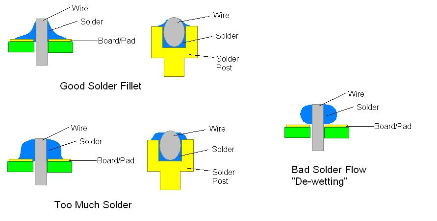

6: Use the right amount of solder
Just enough to coat the parts and make a good solder fillet. (rounded edge of solder between the components)
If you are soldering wires to terminal posts and the posts have slots cut in them like the RX8, and if the wire does not stick up out of the slot, use just enough to reach the top of the wire. Basically you want the solder to not look like a big blob. I have personally saw someone try to solder a wire to a post and there was a huge glob of solder covering the wire and top of the post, yet a small tug on the wire popped it loose. (that is what you get for not using flux) Globs hide bad connections, a good solder fillet proves the connection is good.
Not using enough solder is just as bad, it can make the connection weak physically and electrically. I will post pictures at the end to show some examples of good and bad connections.

The pictures below in order
1 Proper solder fillet

4 Examples of good fillets, too much solder and bad solder flow
5 Too much heat and pressure can cause damage.

Name:	proper fillet.gif
ID:	511101   Click image for larger version

Name:	(No delete)Too much heat example.jpg
