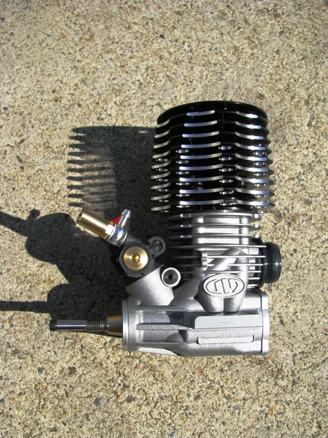

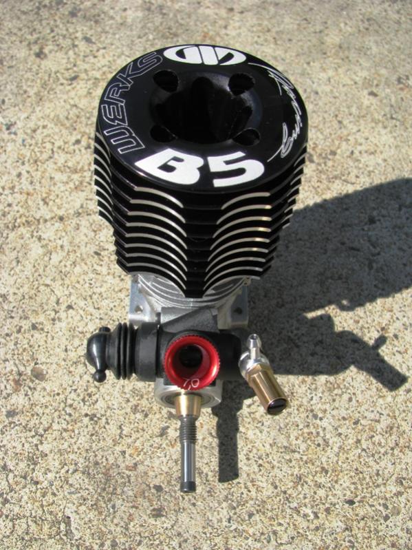

Hello guys, after months of testing I'm happy to say that we are finally starting to ship our new TL21B5 engine today! The B5 is our new 5 port racing engine design. Kortz has been running final specification pre-production engines for the last couple of months for a final shake down under actual racing conditions and has put his seal of approval on it!
This is exactly the same engines that Jeremy used to take 2nd at the RC Pro Series Australia race as well as make the mains at last months ROAR Buggy Nats! Actually to be specific, Kortz used 1 single engine to run both the 5 day Pro Series Australia race, the 5 day ROAR Nats as well as 5 or 6 Hot Rod Hobbies races in between! He is still racing the same engine lol but the fact that (at his level of racing) he chose to run a single engine (without re-building) at 2 races of that level plus a bunch of club racing should say something about the build quality and longevity of the engine.
Specifications on the B5 are as follows:
Stroke = 16.50mm
Bore = 16.30mm
RPM RANGE = 3000 to 39000
Output = 2.6ps at 33000 rpm
Sleeve chrome plated five ports
Piston machined out of high-silicon content aluminum alloy
Double bushed knife edged connecting rod made with special 7075T6 aluminum alloy
Composite 2 needle carburetor with adjustable venturi (7mm stock).
CNC machined, lightened, low CG cooling head design
The performance of this engine is awesome and for those that have ran our B7-Pro before it will feel like the power band has been shifted down slightly. It still provides the same extremely smooth, linear power band but with more bottom end and slightly less top end (which the B7-Pro has an abundance of lol!). We have also significantly increased the fuel efficiency of the B5 which is now a 10 minute + engine!
Most importantly for you the consumer I think is that we have taken a very aggressive approach to the pricing on this engine. I started working on the design of this engine a little over a year ago for two reason. First I was looking at the market being inundated with low cost and unfortunately often (in my opinion) questionable quality Asian made engines. I felt that we could make something better performing and of significantly higher quality working with our existing Italian manufacturing partners. Secondly I could tell the direction that the economy was going in and frankly we all need to make our bucks go a whole lot further nowadays. From these thoughts has come the B5, the first low cost Italian racing engine that is already race proven at the Nats and RC Pro Series!
A-main will be getting a shipment of these in tomorrow and you can find information on their site about them here:
http://www.amainhobbies.com/product_...ine-Turbo-Plug
A couple of quick photos follows, let me know if you guys have any questions!
