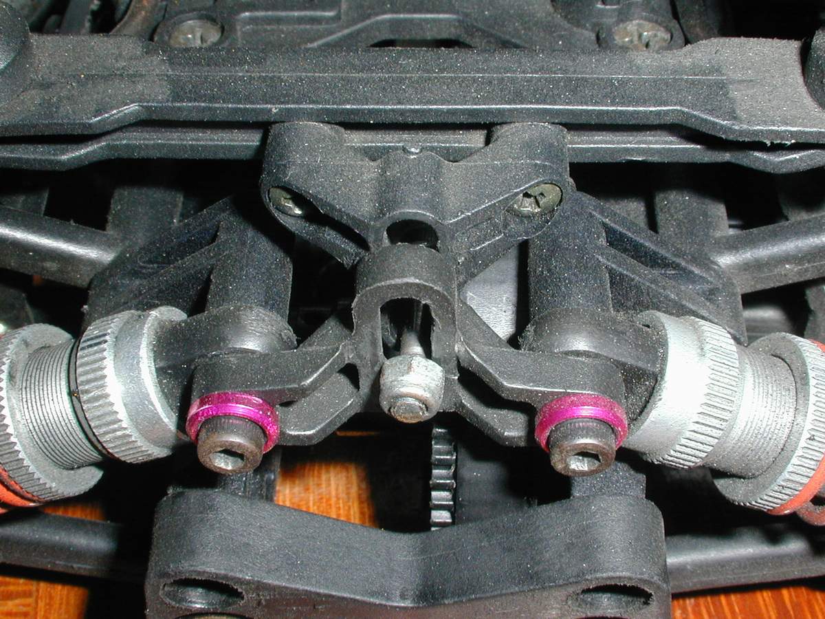

Originally posted by Fernando_M
The rear tower 808138 in not optional. It is needed as it holds the pin that keep the rear body support in place. I don't know the 808139, it is not in mytsn.
You are right Fernando. It was an oversight from my part. My apologies to lawndoggie.
On my Impulse PRO (now already converted to 705), I use a different way to keep the pin in place to help keep the rear floating mount mounted correct. Please see pic attached. I use part of the Streetspec Shock Support mounting 808137 as I do not use any rear shock tower.
Yes, 808139 is not mentioned and listed on mytsn but Serpent does sell it separately. Don't know why. I have and use this on my 705 with TC body but actually never had the opportunity to test it nor the need to use the alternative shock hole mounting.
