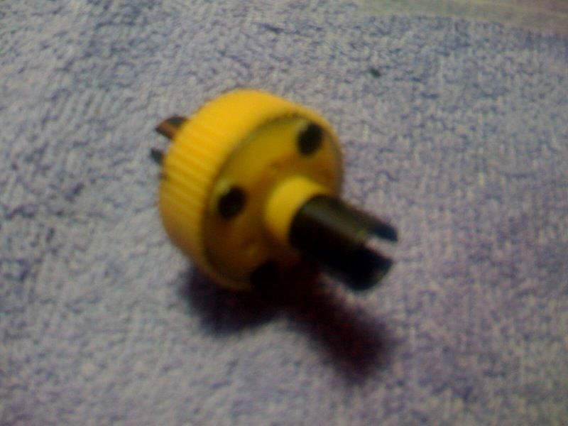

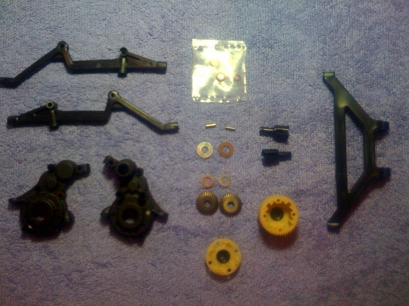

The assembly has been really smooth. No missing or damage fastners. Everything needed to complete a step is individually packaged.
Guys who have an SC8, the SC10 mudflaps are exactly the same part.
For guys about to build, if you have fumbly fingers you may want to make sure you have extra hardware (plain washers, screws, etc), because the parts included are the amount necessary to complete the task.
When you get to the transmission assembly in Step 7, leave the rear bumper lower brace loose. You can snug it once your are ready to finish Step 9.
