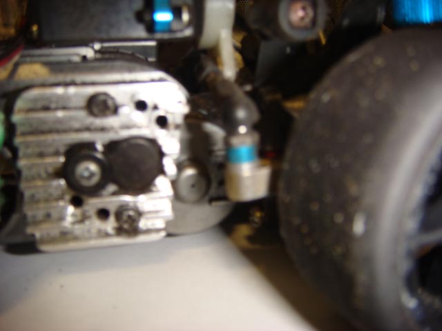

Here are the photo's of that I said I would post. These are of the knuckle post using a droop screw, spacer and teflon ball stud. The servo saver is the Kimborough large servo saver cut down and using the bottom outside holes reamed out to accept the ball studs.
Steering tie rods adjusted to run 0.5 degree toe out.
