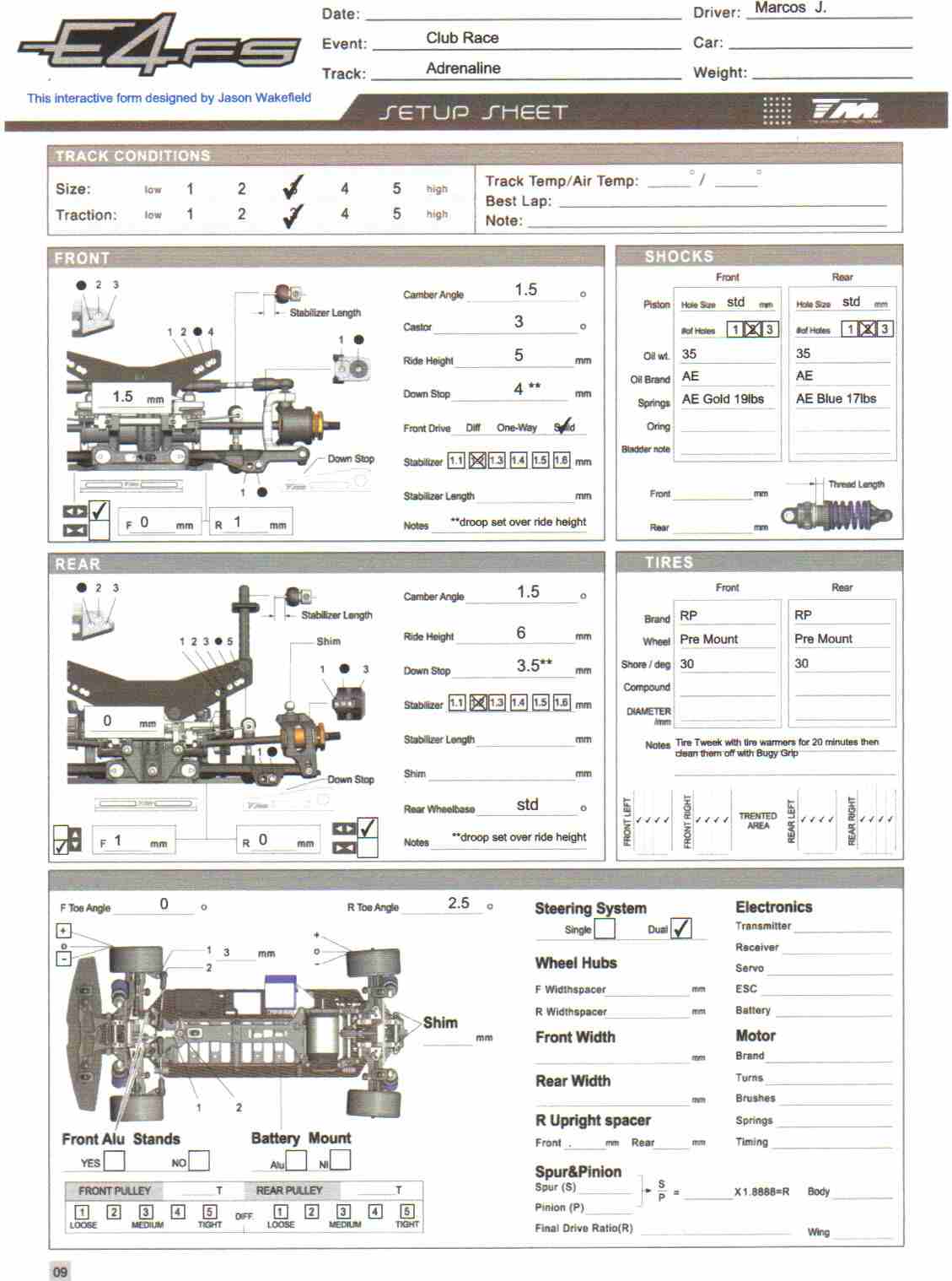

Originally Posted by Smarty
Is there a website that helps with setup? What I mean is a guide that says if I move this bit here it does this to the car type of thing?
My car is driving very well, but I seem to be getting a bit of rear end slide into the corner. I have been running the original bling e4 with the basic kit setup, sorex 28 tyres. Running on asphalt with a 13.5 brushless (soon to be 10.5)
Any ideas on what to do to improve it? or where I can get the info on what to do to make the car do .....?
try this set up and see what happens.
Name:	e4 set up.jpg
