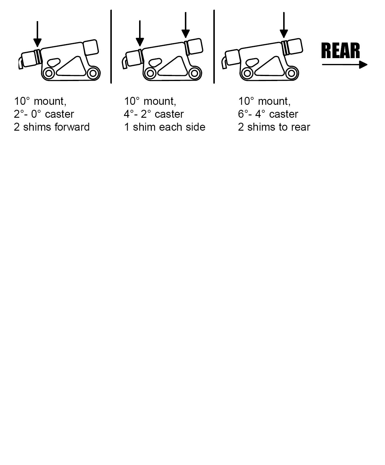

Originally Posted by protc3
hmm,the only static castor adjustment i see on the AE front end is between 2 and 4 degrees.shims centered is 3 degrees.i dont know what they claim but this is actual measurement.
This from the L3 instructions.....when my shims are centered the actual static castor is 4-4.5*.
