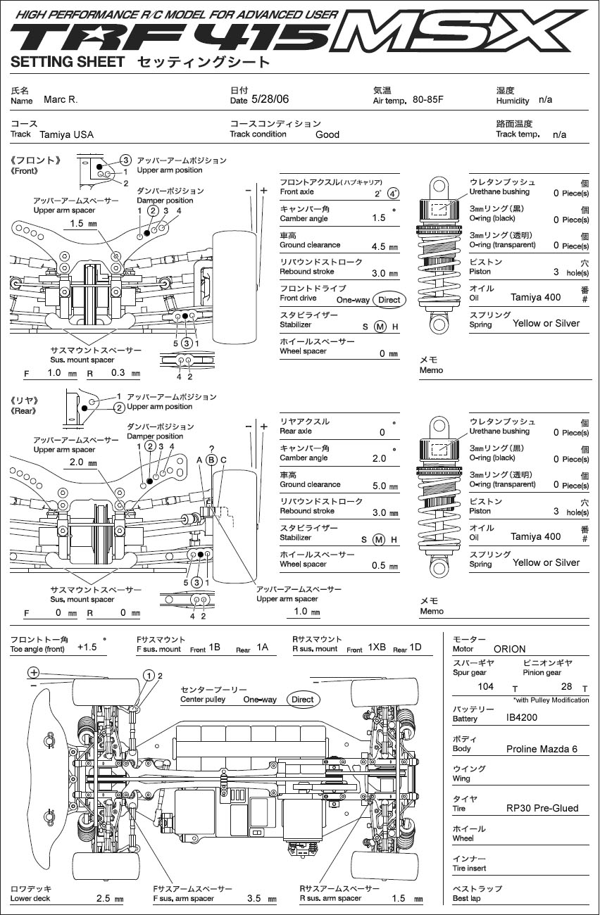

Hi guys...I avoided posting this until I gave it a try and for Tamiya USA to post it but here's a sneak peak of Marc's Reedy Race setup that Kiyo kindly wrote down. We sweated it out at the track today (freaking hot) trying it out and it is money Wished I went towards this setup direction last week...doh!
Note: The foam and o-ring part on the setup sheet is blank. There was nothing in the shock except the seal. Also, I believe that the front toe is 1.5 total.
