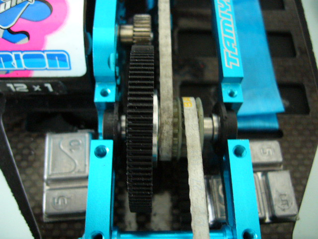

hey anyone can show a pic how to put the TA05 center pulley with the shaft into 415 center shaft. i have try to put in but cannot fit properly, thanks
We posted this yesterday, but here we go again...
These are the TA05 parts you need for the MSX fixed center pully conversion
- 51214 Centershaft
- 9808019 Centershaft-C-rings
- 9808018 Centershaft-Spacer (alu 2,8mm wide)
- 51213 Centerpullys (2pcs.)
- 3455870 Spurgear-holder
- 53874 precision-bushing (1pcs.)
- 9805672 BB 840 (2pcs.)
- 51211 Spurgear-screws
- 53586 spacer for centershaft
Stein
