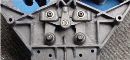

Here's a picture of my friends car with the NTC3 rack. This was a "first try" for me, so it can be done cleaner. I have seen it done on a mill too (vs. a dremel), that looks alot better. When the cars assembled it looks killer. The parts bags you'll need are #2228 swing rack, 2229 swing rack hardware, and 1714 swing rack bearing kit. You'll also need 3 short ball studs for the rack.
