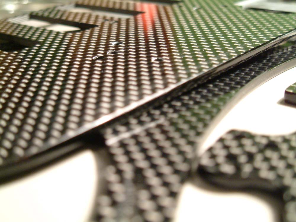

i've just finished preparing the carbon fibre edges on my Xray T2 and i'd like to share the technique, as the edges came up piano black! wow!

it should look really good. the white bits in the picture you see is actually the reflection of the CF pattern from the peice underneith mirroring itself on the edge! very shiney!
the trick in this process is the black marker. the black once coated with the CA becomes very shiney. if you don't use the marker, you will be able to see the sheets through the glue, and the edges won't be as dark, or as shiney looks awesome on a well built T2 IF YOU USE BLUE FASCOLOUR, OR ANY RUBBERY, FLEXIBLE TYPE PAINT, YOU CAN ALSO GET A COLOURED EDGE.
