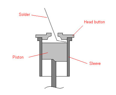

Just make sure you get a good bit of the solder under the flat part of the head button, like this pic shows..
good old microsoft paint
Edit: use pretty thin solder also, you'll only be measuring 0.5mm at most.
