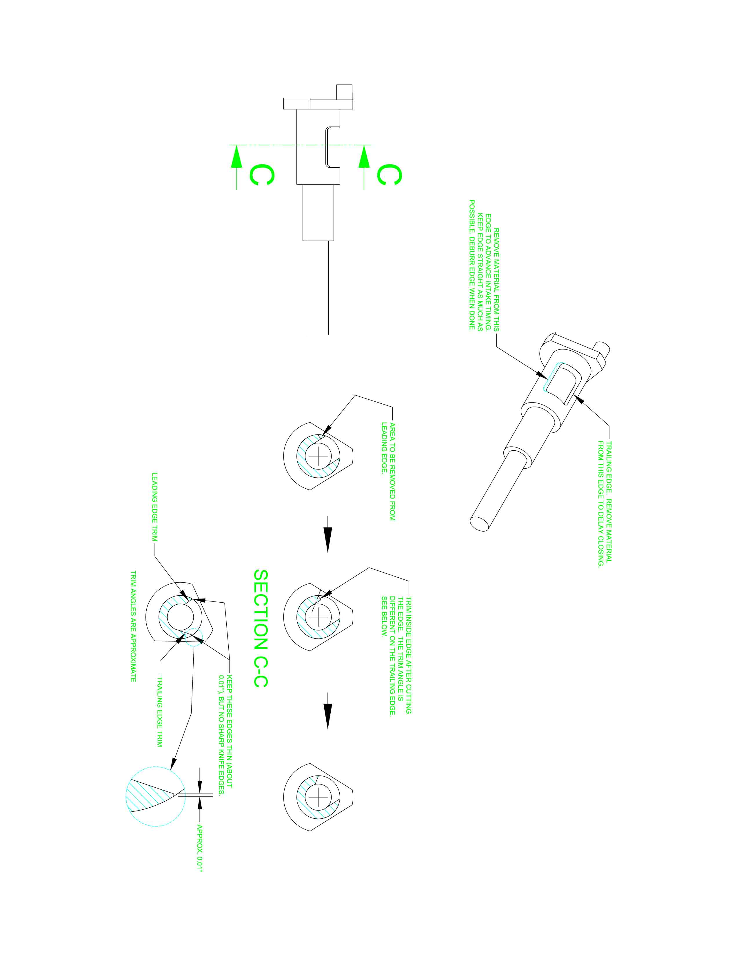

Originally posted by BundyMan
A simple question, once the crank timing is establish...how do you change it?
Rgds
basic timing mod on crank, per your request.
data
