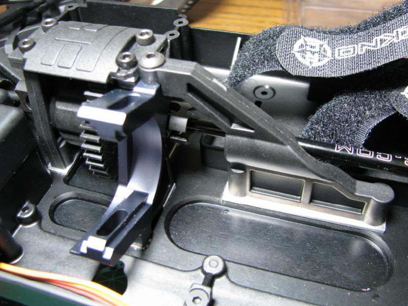

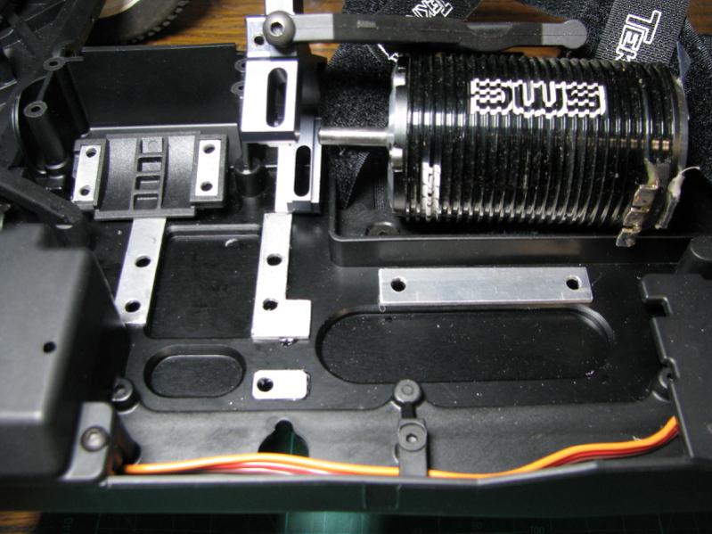

Hi guys
FYI
I had successfully raised the motor mount, CD mount, support brace and the top plate by 1.47mm.
Just can't wait too long, so Sunday night I found a piece of 1.47mm aluminum and go ahead to make the spacers. Vola it is done.
Now I have 2.47mm gaps from the 44T spur gear to the chassis.
44T is 46mm, 46T is 48mm, test out a team Associated 46T CD and still have
1.3mm gap left, may be 48T will fit too.
Now instead of getting a whole set CD from Losi, I use the 48T spur from Tekno
TKR5415C 48T steel gear.
I prefer 48T spur gear that gave me more power options when I use different sizes of tires, just simply change the pinion gears.
