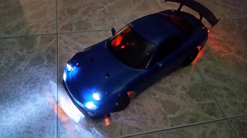

Hello guys! I haven't written in a while. Today I've got some news for you. I installed a carbon look rear wing (I don't know if it gives some downforce, but it gives an awesome JDM look ) and a light kit, so now I can bash even by night
The kit receives signals from the receiver and is powered by the BEC. When the car is not moving stop lights and headlights light up dimly; headlights fully light up when accelerating , stop lights fully light up when braking and turn lights flash when turning. If the module doesn't receive any signal for few seconds, all lights flash.
