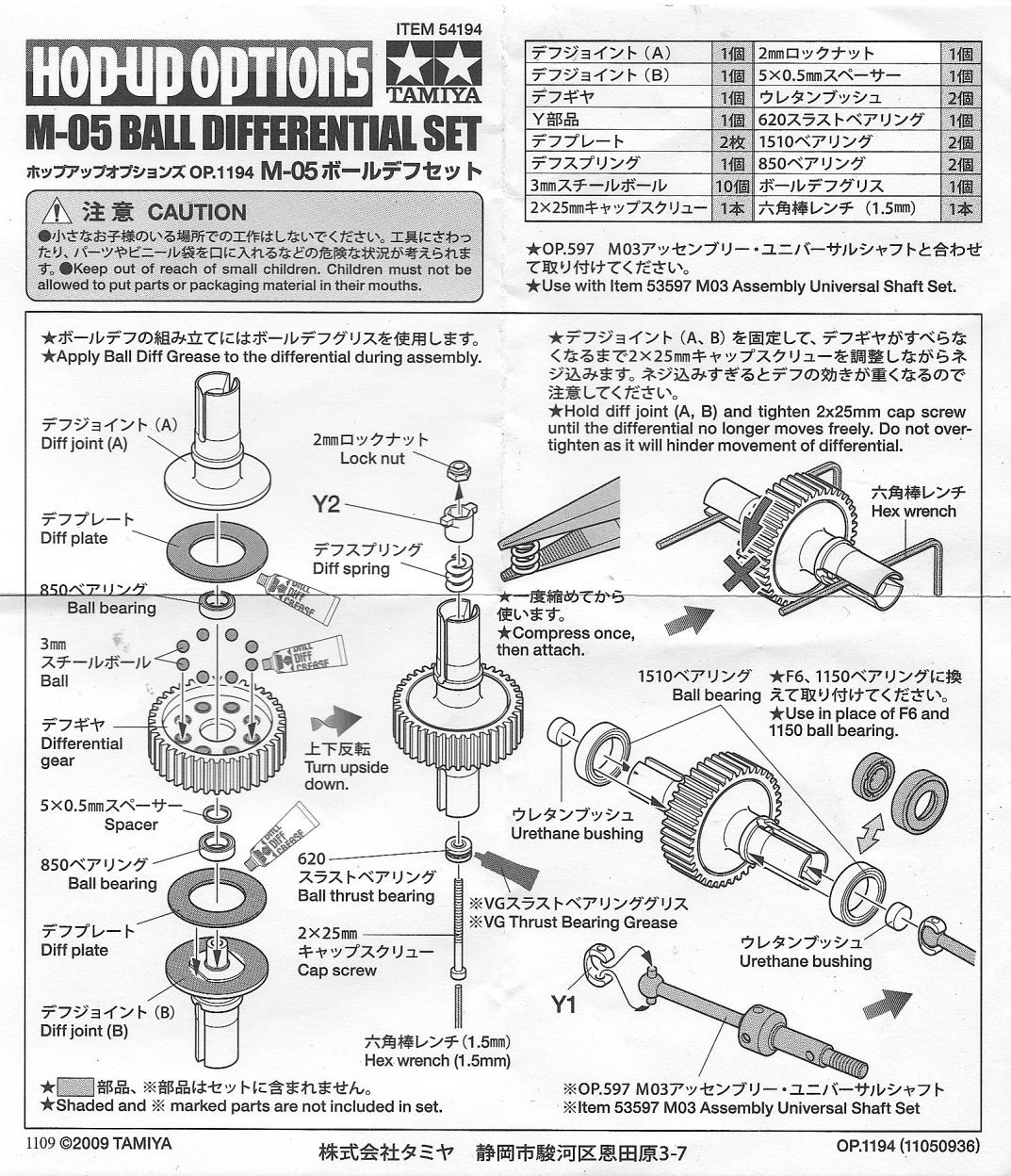

Originally Posted by k_bojar
does anyone have a copy, or can get a copy/scan/whatever, of the M05 ball diff directions?
I somehow lost mine and trying to rebuild my diff and am having a 'senior' moment
thanks!
Is this it?
