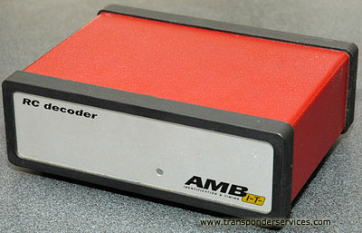

Hi Guys,
my name is Sascha and I'm from Germany.
I have a AMB RC2 decoder connected to the PC (RS232).
The decoder sends every second the value "#690F" to the COM-Port 1.
If a transponder passes the loop then I get the following value:
Code:
example 1:
$6900111145018551552D9C00
example 2:
$6900039E0601856BD52D9900
How is the data structured? What sends me the decoder?
A few data I got out alone:-)
Code:
$6900 111145 01855155 2D9C00
$6900 - not important, is always the same value
111145 - the transponder code
01855155 - is the timestamp from the decoder (milliseconds since launch this)
What data contains the last block (2D9C00 in example)?
I have read something of hits and signal strenght. How exactly is it structured?
I am not receiving logical relationships when I convert it to decimal. If hits should be the loop crossings, then the values are not contiguously.
Can someone help me further?
Greeting Sascha
