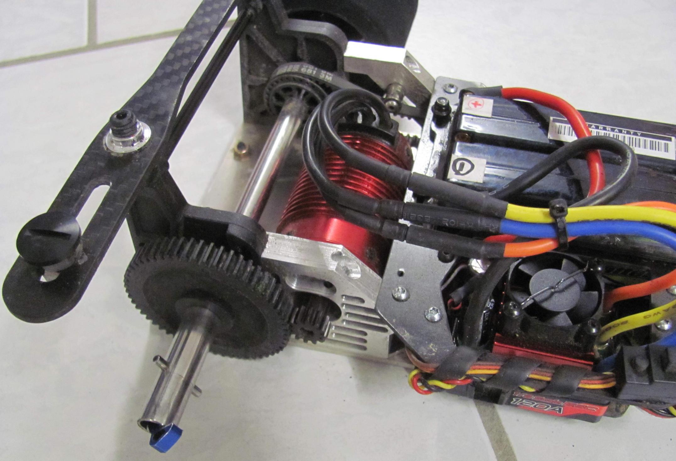

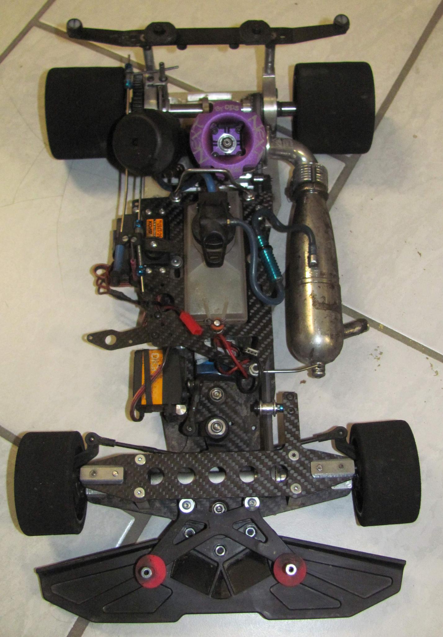

First my V3 with a divided rear axle (to get toe and camber on the rear) after a race with Mugen, Serpent ....
It is about 1.5 to 2.0 sec slower laptimes than the tops - without 2-speed and with a 5-port OPS engine and fuel stops after 7.5 minutes.

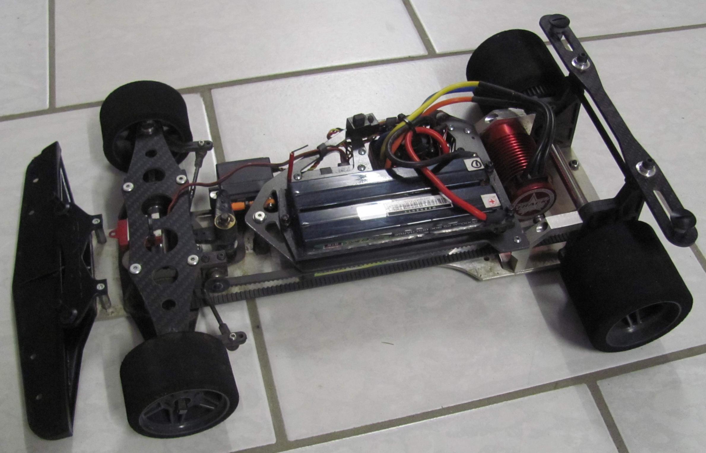

Second the electric version with a smaller 1680W / 2300KV motor and 120A esc.
Enough power to have a lot of fun. Top speed on the straight for the MORAC-Graz track checked with radar gun: 97 km/h
