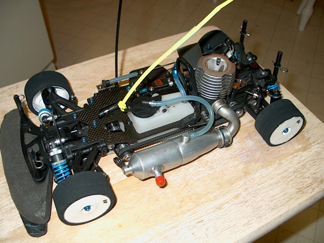

Yet another needle setting for the O.S. .12 TR (P)-T R-Spec.
High side needle 1 1/4 out from closed.
Low side needle 2 3/4 out from closed.
(Middle is per instructions 1 1/2 in from flush with the carb body).
All these settings are after break in. I also can get over nine min of race time at about 218 deg. But I intend to try the other settings listed. Just to see what difference they make.
