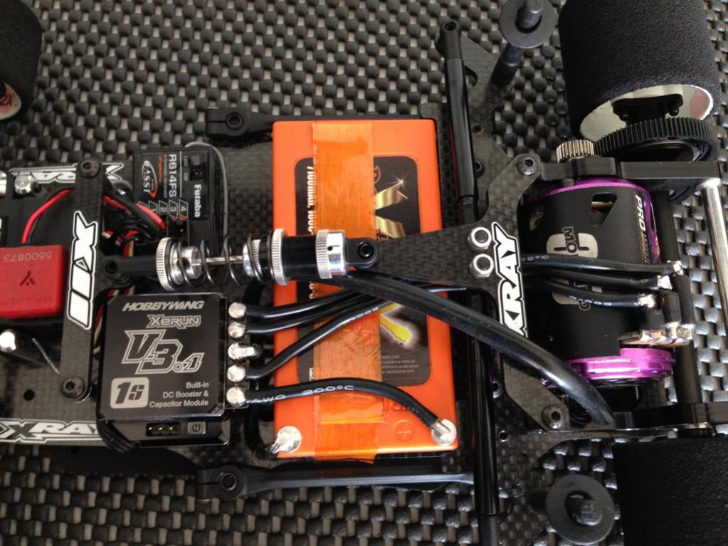

I just changed from the orion R10 esc to the hobbywing V3.1 to save some chassis space.
Eliminated the external caps and the external switch.
Also changed the wiring to 14g batt and 16g motor wires with motor tabs extensions.
No more wiring tweaking!
The hobbywing delivers a much smoother power than the orion. Liking it so far!
