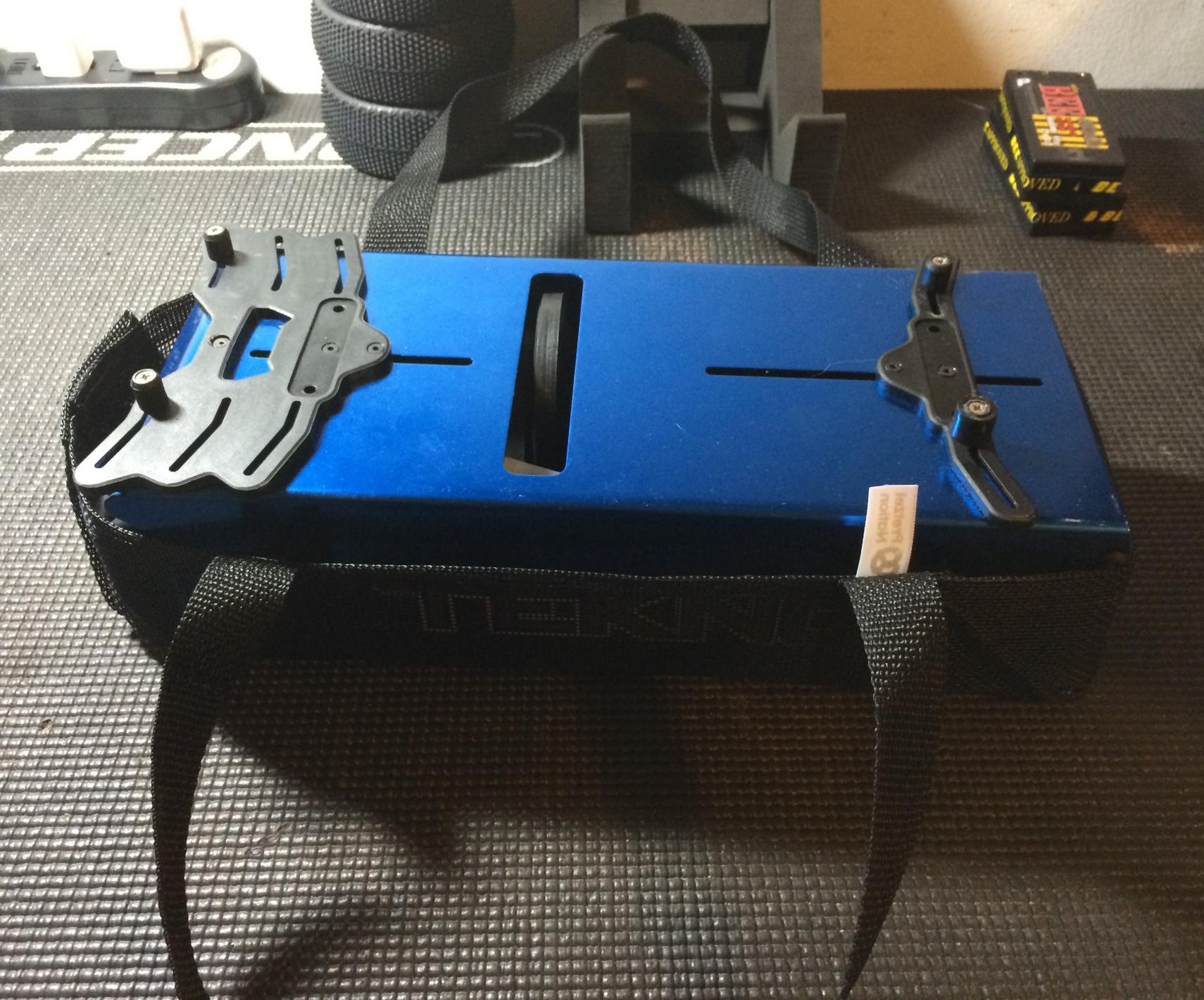

Originally Posted by wallride14
Having some trouble getting my blue ofna box to work. Its been used before so the wheel is worn down to 74mm instead of what it is new (76mm). But I don't think that's the problem because the wheel is being stopped by the chassis and I would think a smaller wheel would fit up in the slot further and make contact with the flywheel easier? I definitely don't wont to grind out the slot/chassis to get it in there, but the flywheel seems really raised. What other starter boxes are guys having luck with?
I had to do what mr240 explained. Switched the brackets and drilled a new hole to close the top. You'll notice the pegs shifted to the left as well. I've also added rubber tubing to the front right peg to tighten the fit up.
