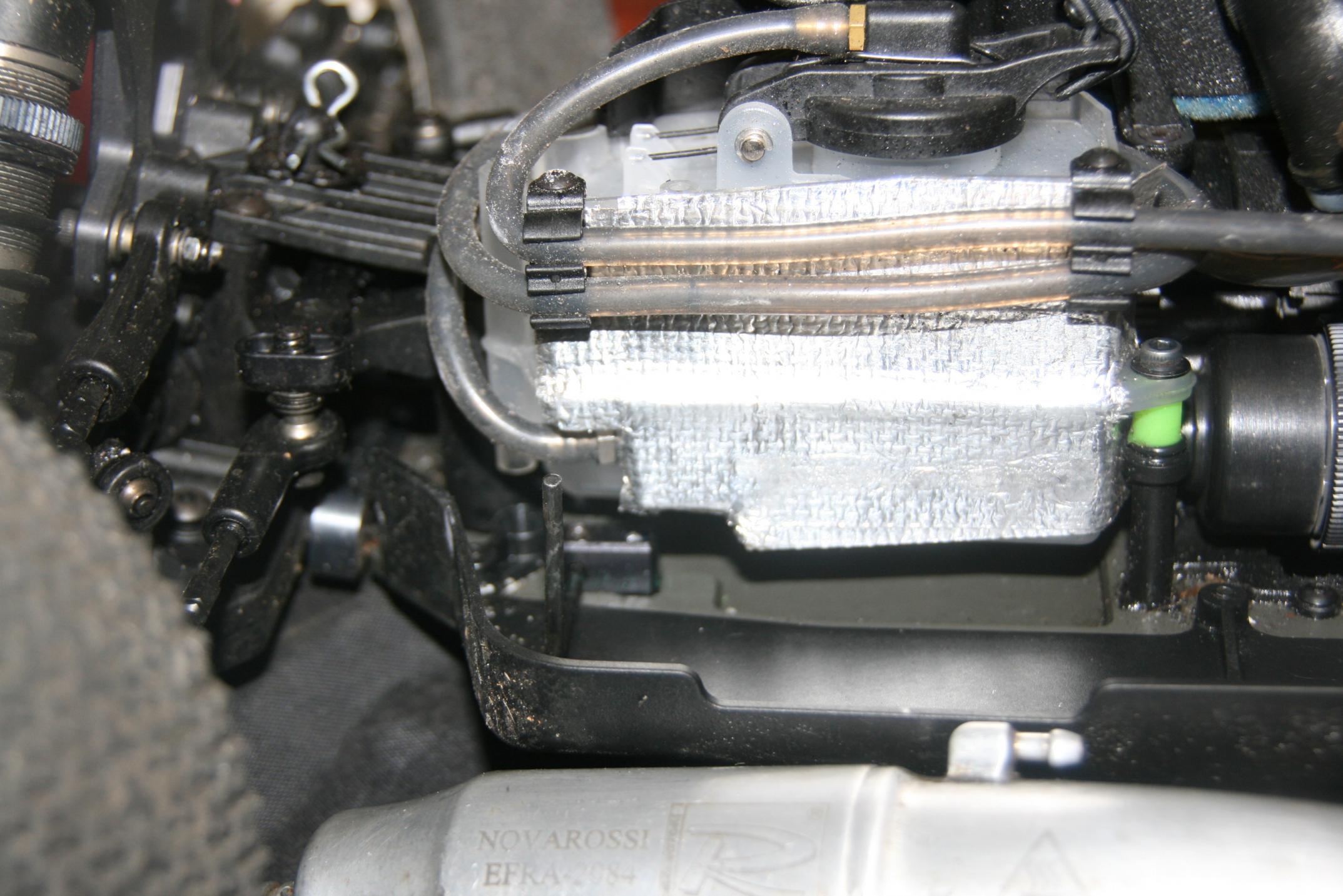

Originally Posted by 08supermoto
Make sure you put the washer that comes with the kit above the tank....
It should be:
screw
washer
tank
fuel line
double O-rings
tank mounting post....
That's How I have it.
Attachment 1175885
Cool thanks for the pics. How long of fuel line are you using for the extra cushion? 5mm? You did it on both tank posts?
