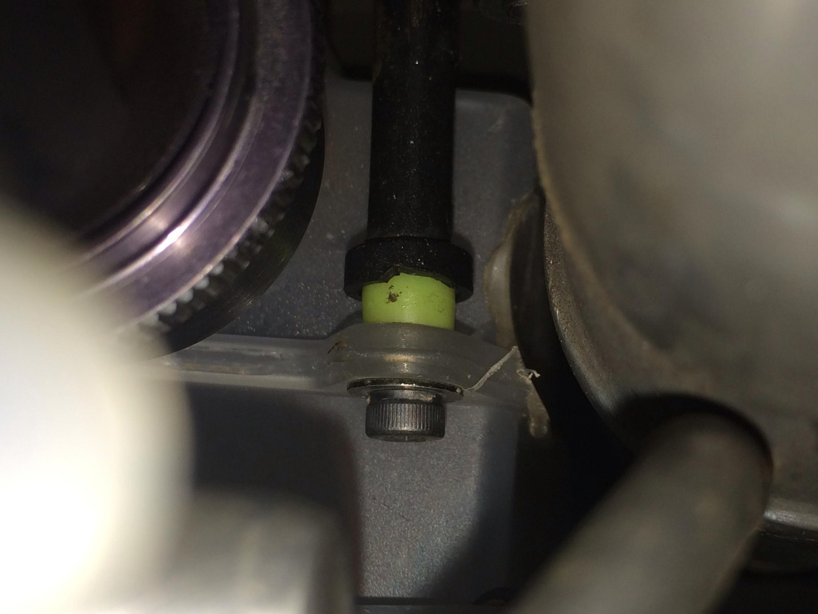

Simple and easy to fix , drill out the hole and install 10mm of fuel tubing which is yellow in my case in picture.
Plenty of cushioning and it does not look silly at all as no one even see it
Any other questions just ask.
Ok just noticed my picture is upside down again DOH. Lol. But you get the point
