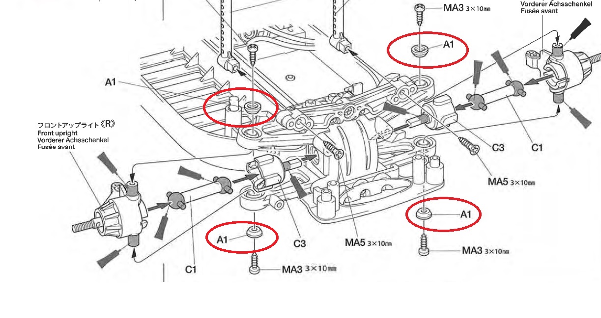

Originally Posted by visuvius
Does anyone know if he Front Uprights on the TT01 and TT02 are the same? I broke one of the front uprights on my TT02 and I can't find the replacement part 51527 nearby. The only one I can find is the A parts for the TT01.
@visuvius: The TT01 Front Uprights will fit without modification. You also need the plastic part where the screw seats from the TT01 (see attached pic). Just check the ride height because it will be high. Use spacers inside the shocks to limit down travel.
