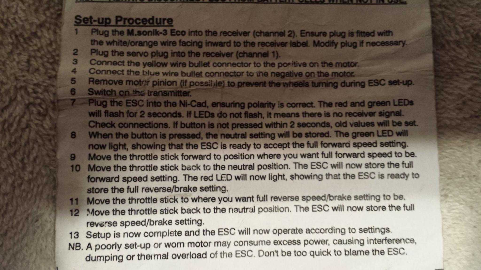

Here's instructions . I've had a few of these and noticed on some you have to touch the set up button when at full then reverse then neutral for it to hold the setting.
