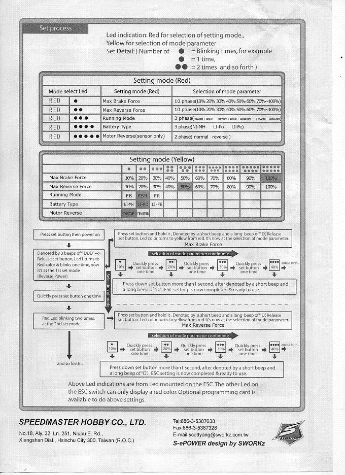

Hi Hpikillr,
Thanks for responding.
I scan the instruction sheet.
I'm stuck in first mode (max braking force).
I can not move to 2nd, 3rd, and so on mode to program each setting. I read instruction sheet and tried programming the esc for almost an hour with no result.
I should have the RED LED blinking 2 times for 2nd mode, 3 times blink for 3rd mode, and so on right ?
Here's what I tried,
1. Press set button then power on
2. Yellow led blink with 3 beeps, then red led blink 1 time.
If I press set button and hold, I'll enter 1st mode setting right ? ok so far so good.
But after step 2 above, if I tried to enter 2nd mode with short press on set button, nothing happened. The red led never blink 2 times.
I tried reverse mode throttle, not working. Tried calling customer service, they dont speak english. My email also got no reply so far.
My only hope is from you guys ... Could someone that might have the same kind of esc setting steps share their knowledge and tell me where did I do wrong ?
