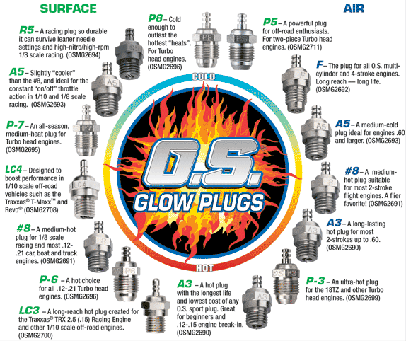

I don't know what kind of engine your running, but amain should have what you need. Like jaz said, your linkage is not set up properly. If you have a manual, It should tell you how to fix. You can also google your vehicle and find manuals online... Here's a chart of heat ranges for os glow plugs....Good Luck...Click image for larger version
