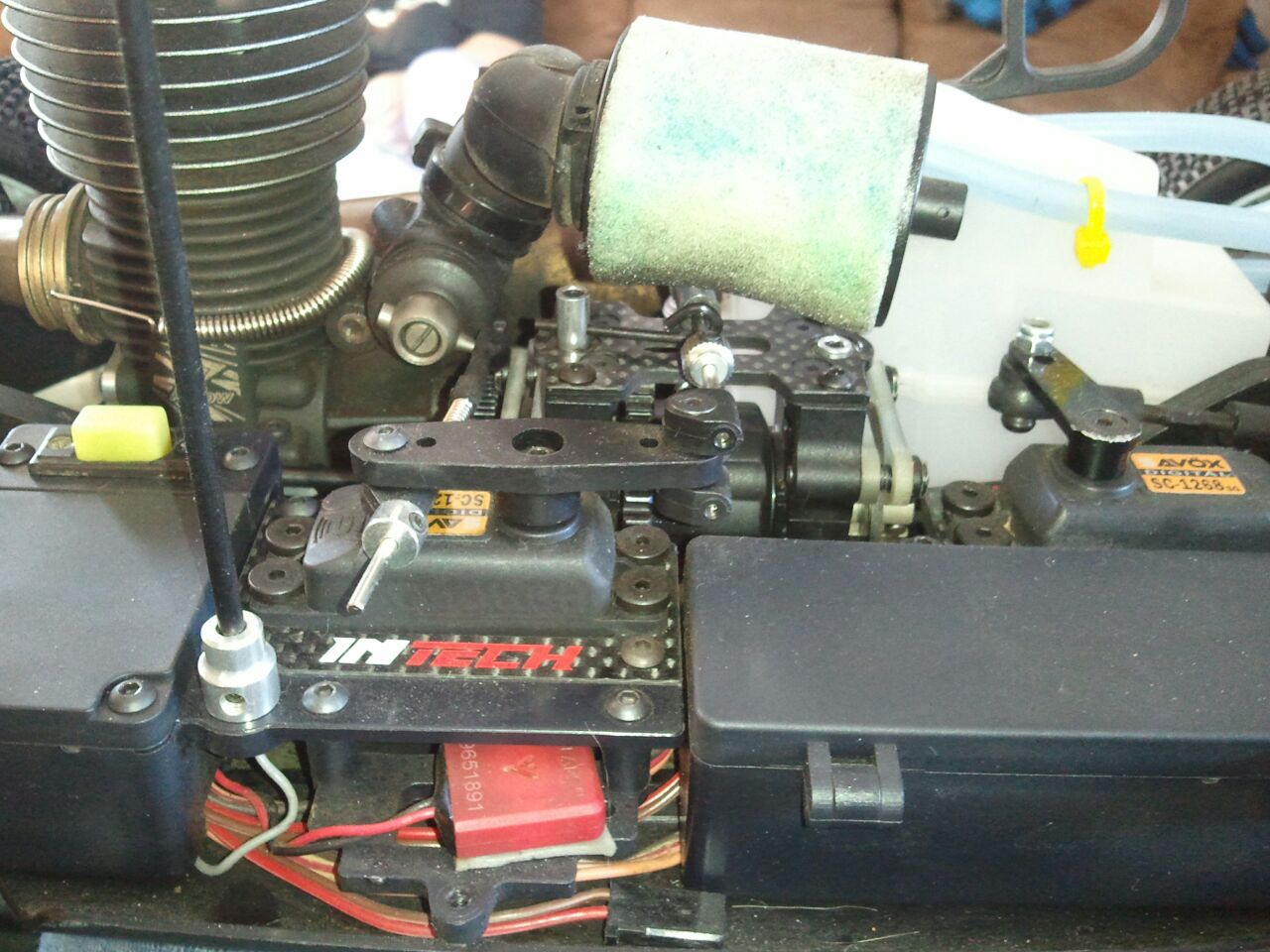

Originally Posted by xxxntwv
That is how the carb ball should be set. The carb does not need to be angled and the linkage should all be straight. Use a longer screw for the brake linkage and use shims to make the rods parallel to the ground for no binding and smooth operation. I use the VP-Pro alum horns.
