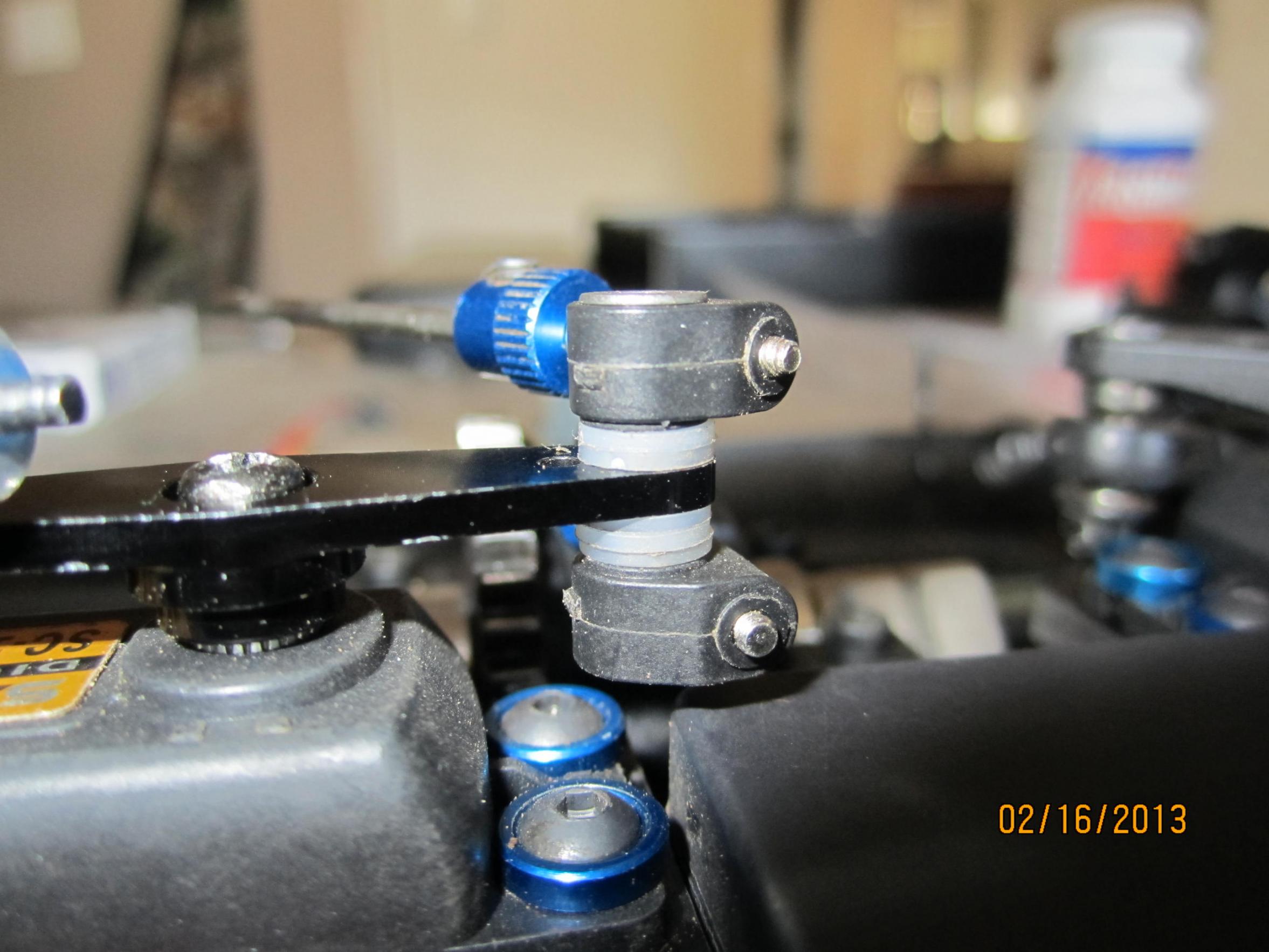

This was my solution to the linkage. As far as the bleeder hole, make sure the bladders are not collapsing into the body. I had this problem with the stock bladders. They seemed a little to big and it was difficult to get the cap around when screwing it on. This left the bladder unsecure. I went to the losi bladders and the cap fits nicely over it.
