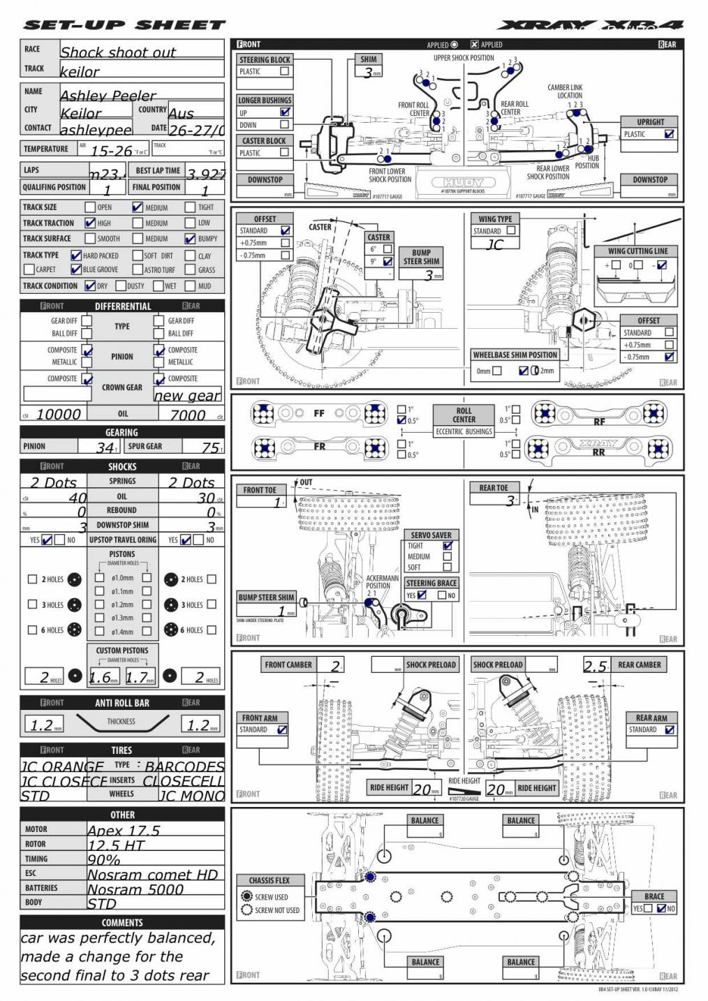

Default XB4 keilor setup
Hi All,
This is the setup I ran at keilor on the weekend, the track was high grip and very bumpy.
The car was very balanced and easy to drive fast.
Ash.
P.S. I'm not to sure how readable it will be, if not just PM me and I will email.
The internet at Ayers Rock is not too good!!!!
