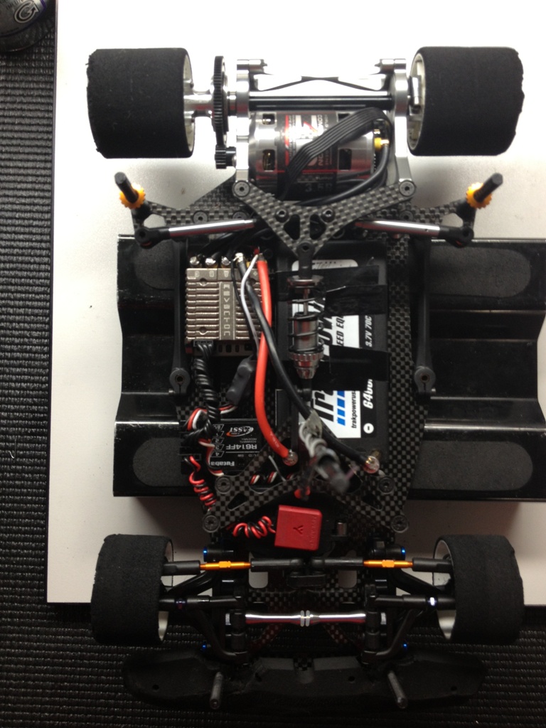

Hey guys, I have a revention pro and was wondering if it runs in blinky mode on a 1s battery in a 1/12 pan car? Cheers guys
Yes, I run my Reventon Pro with a 3.5t Mod motor in Stock0. Runs very well, also ran it with a 17.5t. Make sure you use a 3 wire esc to receiver harness with either a hobbyking booster, or a receiver pack.
