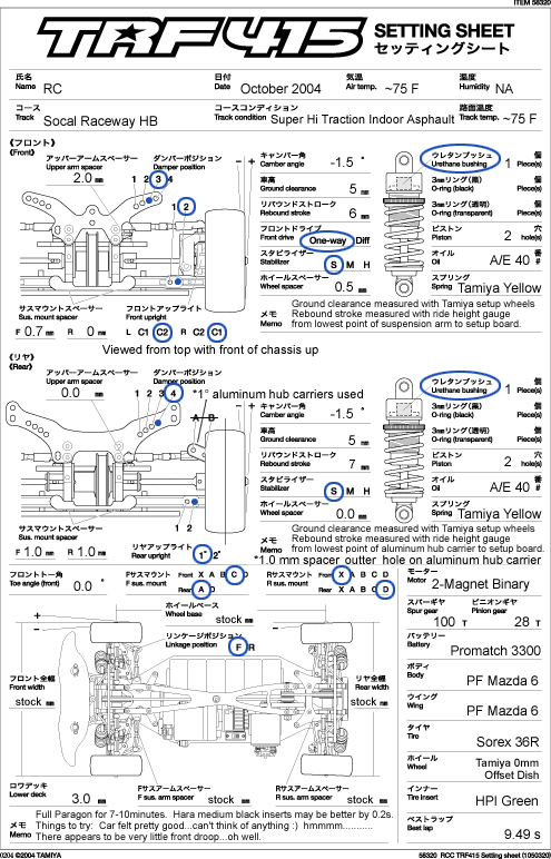

Thanks for letting me by; I had fun working through traffic. It was a mellow night with club racing since I haven't done it in months. Not a bad result eh? hehe Guess what Chris, I could have been a few tenths faster as well but didn't feel like gluing up a set of tires (you'll see why in the setup, and thank you to Atsushi for opening our eyes to his inserts...they are DIALED).
Also, if it rains out at TA this weekend, we might head to socal...
Here's the setup from last night. Keep in mind, I've only ran the car a couple dozen times at socal so far and I'm sure there are ways to improve upon it. Also, this is with the OG suspension :
